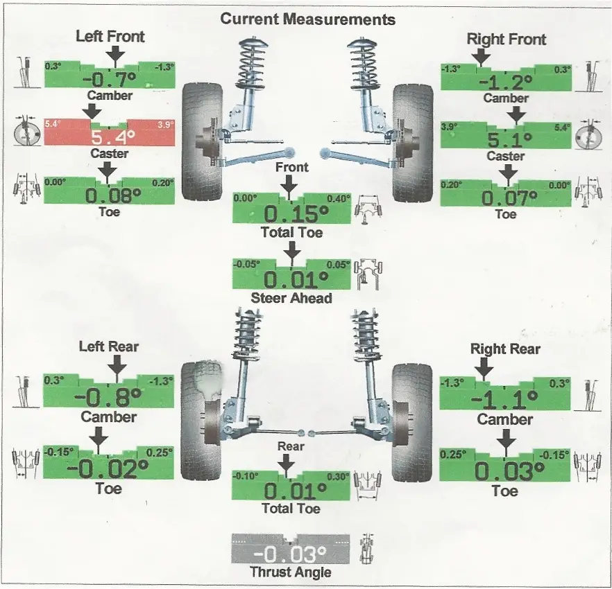

Hey, I'm new here and just recently purchased a Explorer for winter duty
Long story short, my explorer was pulling hard to the right, and I had an alignment done at ford, where they couldn't get everything adjusted properly, camber is on the edge of the negative spec, and caster is overly positive.
After rotating the tires, I found my pull was being caused by the tires as it followed to the other side, but I want to get my alignment closer to the middle of spec before replacing tires. Ford says I need new coil springs, but I don't think the vehicle has sagged that much, and with 120,000KM I don't think coils should need to be replaced just to get camber/caster within spec.
MOOG, sells a Camber Caster kit, but there instructions do not show the same set up as my truck, appears to be 3rd gen. They can't give me any information on where these 4 washers go, and thats my first question. It seems theres no one else having these issues, as I can't find anything online.
Alignment is as follows
