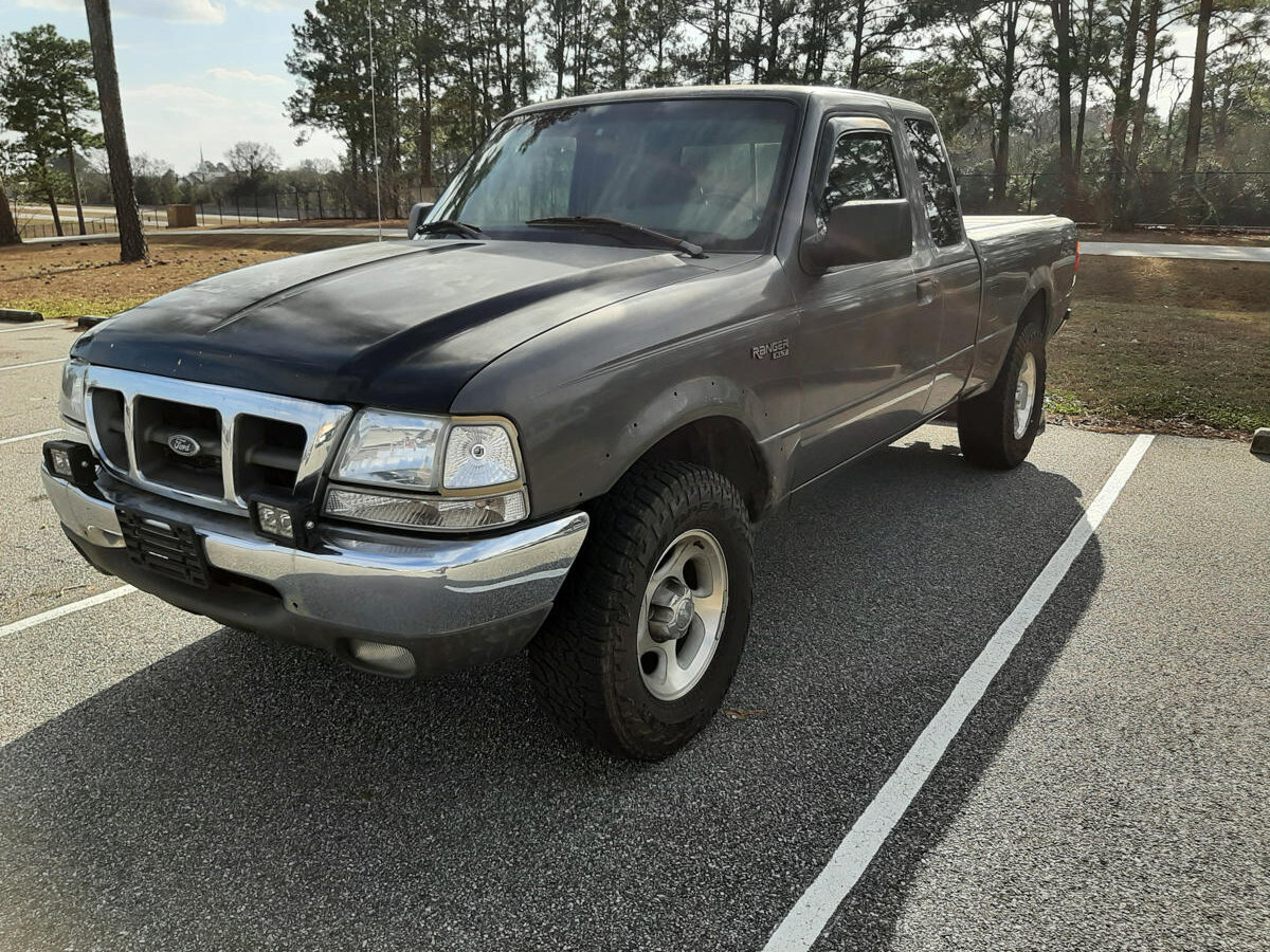

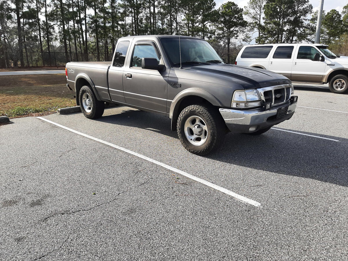

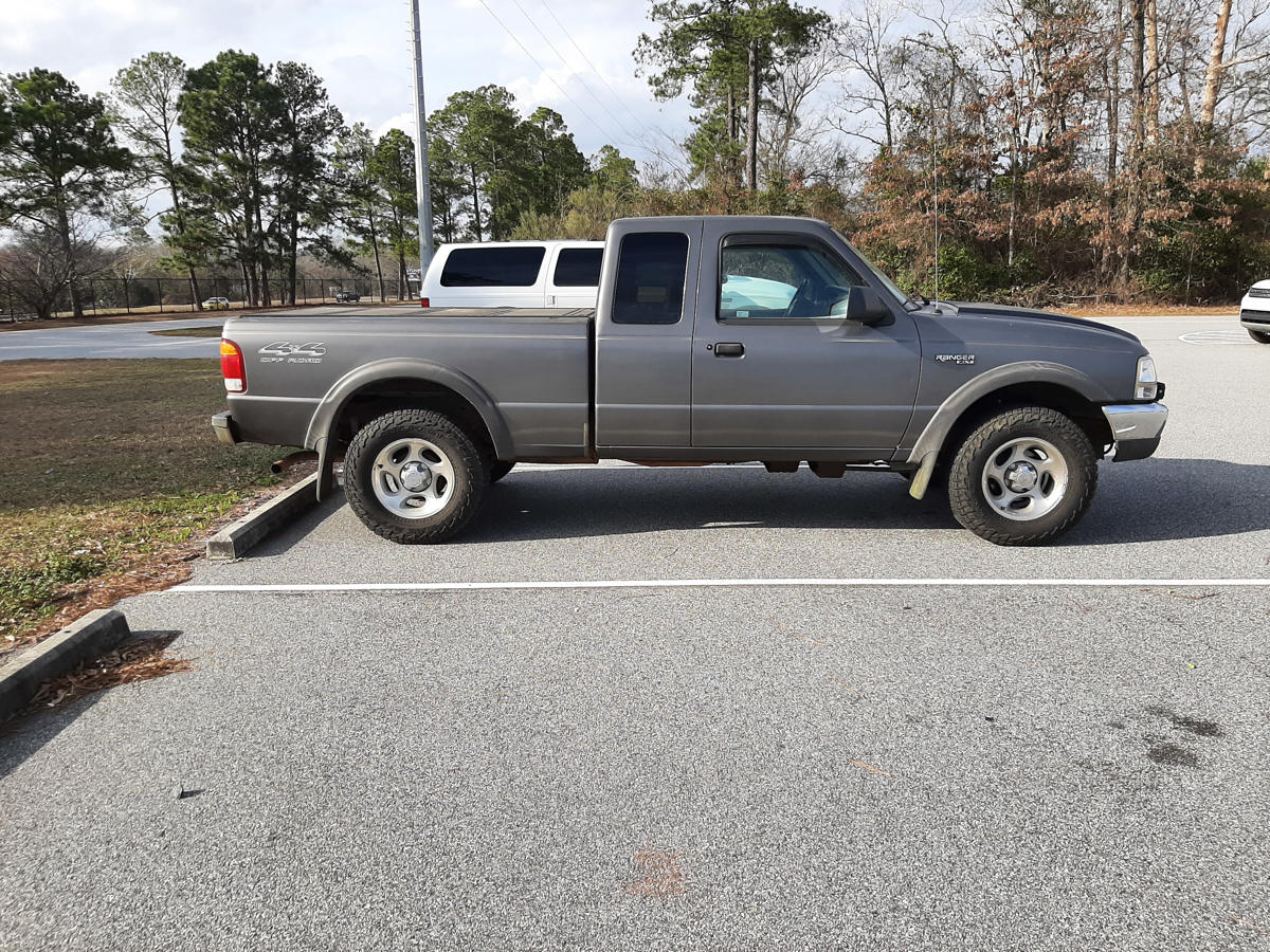

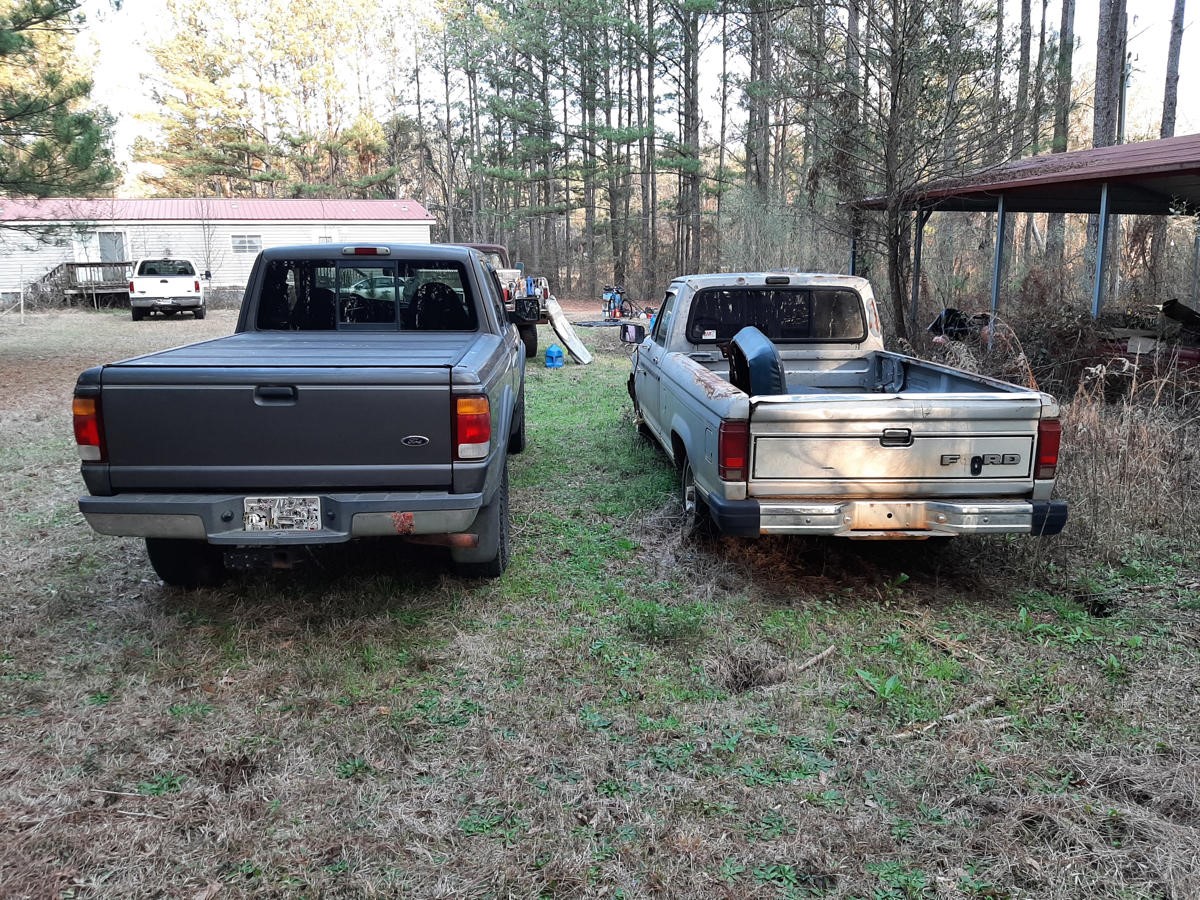

Just to show what I'm working with here's the truck as it currently sits. Also some next to a stock 2wd that happened to be sitting in the parking lot at work today.

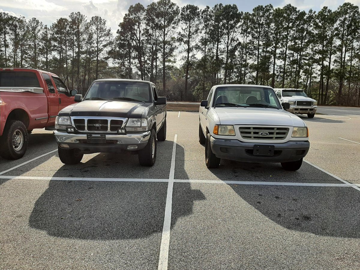

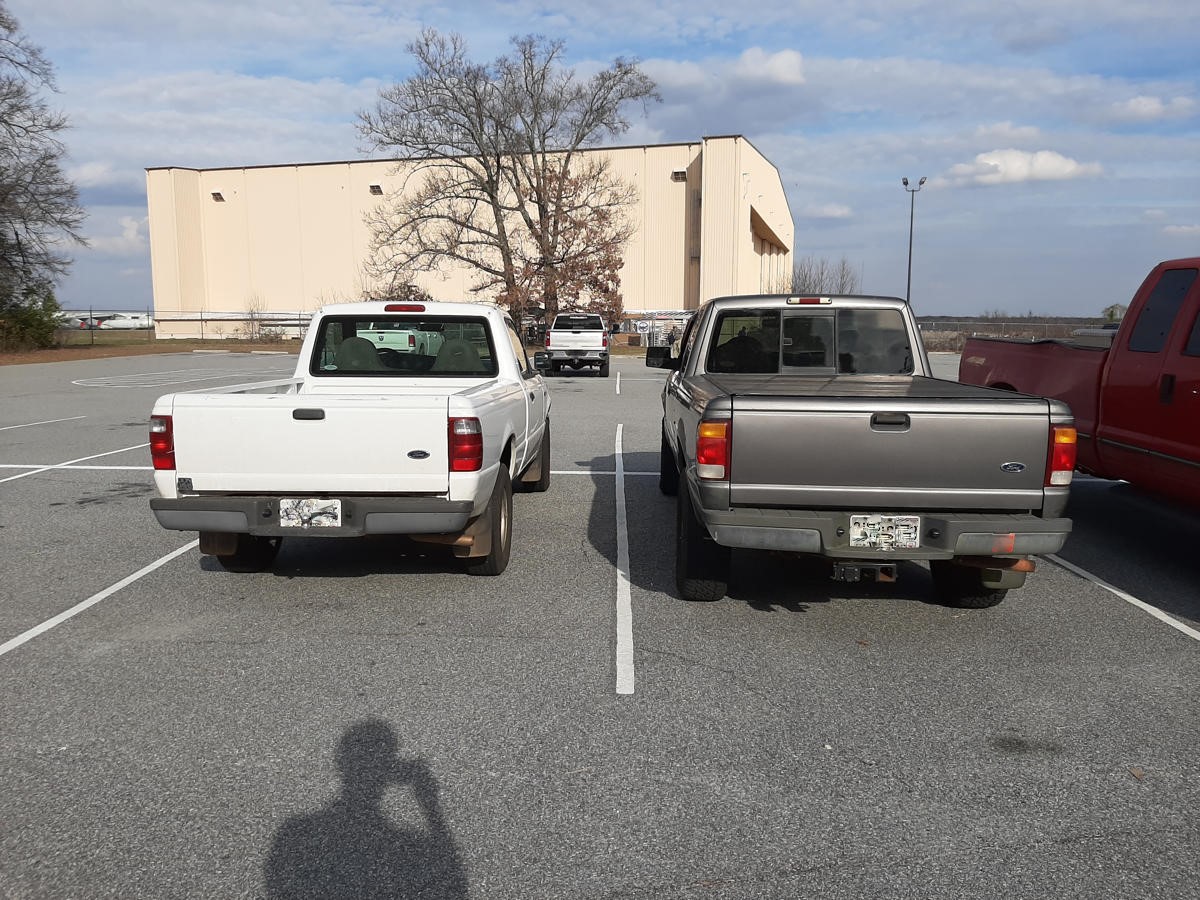

Doesn't look like I've actually got to go all that far to get what I want. Basically imagine someone taking my diameter tires and stuffing them under that white truck, but the white truck retaining about the same ride height. Maybe a tad lower. I guess that the white truck would technically have to be lowered to pull that off. Installing a 2005+ front bumper will also help a lot in pullling off the look I want to achieve.

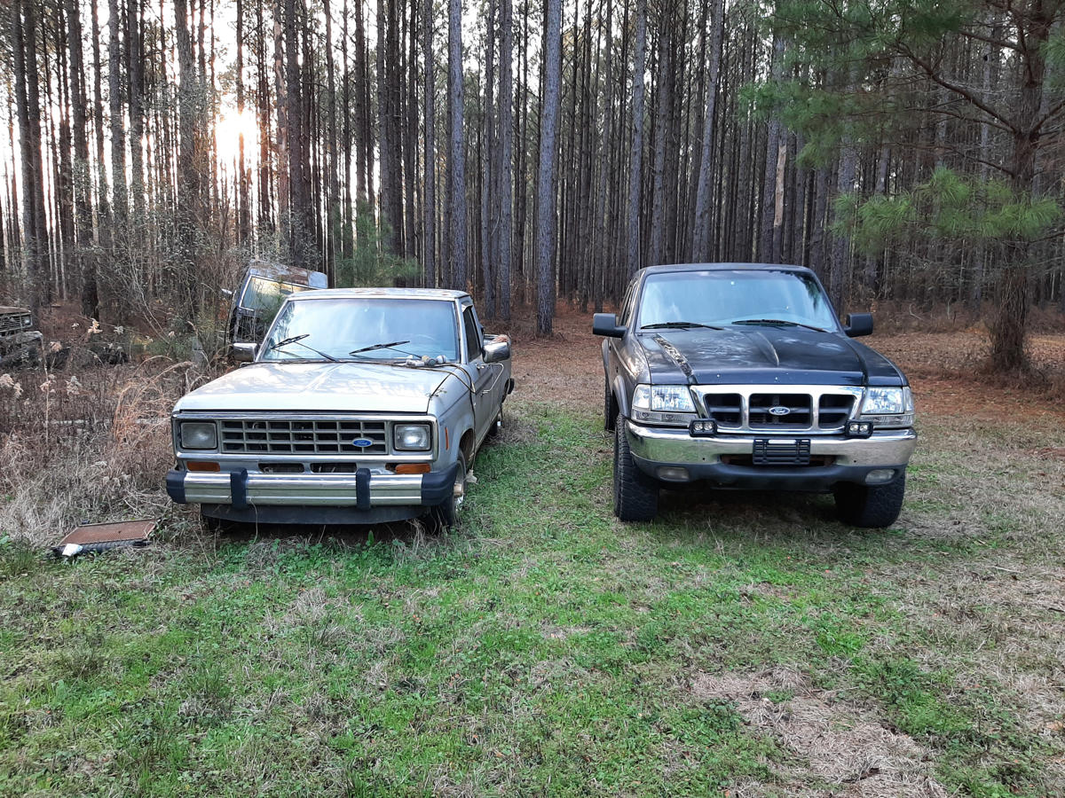

Here it is next to what I thought a year ago was going to be my project. Turns out that first gen is a lot worse off than I first thought and I need a place to blow it apart and do some serious metal work first. It'll probably still happen someday, but instead of the V8 hot rod it was going to be it will probably be a little turbo 4 round town beater. That would be more in line of the spirit I was originally trying to capture by building another first gen.
That last one is all three project/forever trucks in one shot.The 99 of course, it's the one I'm hoping to finish first and relatively soon. Then you can see the 68 F-100 peaking out behind (well in front of) the 99. The 68 is the true passion project and the one that WILL NOT be going anywhere unless something catastrophic (sp?) happens. It was my dad's from the first I can remember, atleast back into the late 80s when he got it from his step dad. I intend to enjoy it as a woods truck while I collect body panels for a full restomod and consider a drivetrain swap from the 360 FE. The 85 is a future project and for down times when I can't make progress on the other two, it's intended as a replacement for the totaled 84 hiding behind the shed.
FWIW, I'm the sole owner/driver of all the junk pictured in my yard, and some that isn't.
Excellent, I love the space and full of parts plans. That's also about the Ranger I might try to look for after I finish many of my other cars. I'd love a Splash bed on one of those with the OEM Gold paint, AWD, and at that point maybe the 3.7/6R80 will be possible. That for just a fun little truck, I've never had a truck(just my three Ranchero's).
