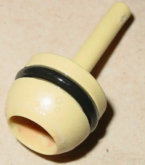

I just dropped my pan and found this little device. What's it for? It was just floating around in there. Was it supposed to be attached some where?
Thanks.

I had one of those in the transmission pan of a 1970 Mustang. I was told that it was a dipstick tube plug that the factory uses in the automatic transmissions, so it is nothing to worry about. I guess they are supposed to pull them out to install the dipstick tube, but apparently sometimes they must push them in to the pan. You can discard the part if you wish, it is not needed.

that is the little throwaway tool the ford factory uses to guide the dipstick to the dipstick tube hole in the tranny,very usefull tool to keep,if you ever have to replace the dip stick,it also will work good as a plug for the dipstick hole when removing the dipstick to R&R the tranny. GM has a neat little one too..;)

I found that thing in mine also. At first I was like wtf and confused, but after some thought I realized it was to plug the dipstick hole. Somewhat convenient when the trans is sitting on the floor of the garage without a dipstick tube.

its there from the assy. line, a lot of head scratching over that one!!
