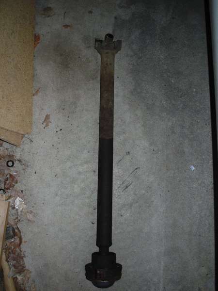

1 Ford driveshaft out........
And guess what? The problem went away!!
I was so happy I drove around my house twice. :burnout:
So does that mean my T-case is broken? :(
-Andy
And guess what? The problem went away!! So does that mean my T-case is broken? :(
Yes. You need a new (different) t-case. You CAN run 2wd until you find one.
