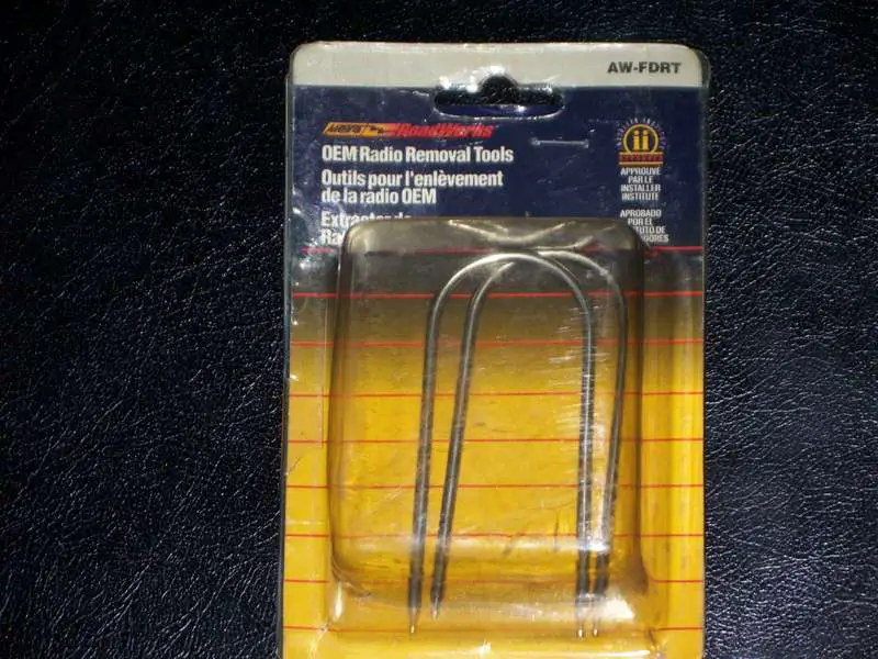

As many of you already know, Ford blend door actuators aren't designed to last for the life of the vehicle. Some vehicles require a lot of work to replace this part while others are not as complicated. The 2004 Taurus has an actuator with four 8 MM bolts which are easy to reach. You will need a 1/4" drive ratchet, extension, radio removal tools, 8 MM deep & regular depth sockets. This is the radio removal tool:
Both of these wishbone or horseshoe shaped tools are inserted into the front face panel, then are moved at a slight angle while you pull on the entire assembly. The actuator is unplugged:
