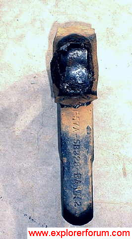

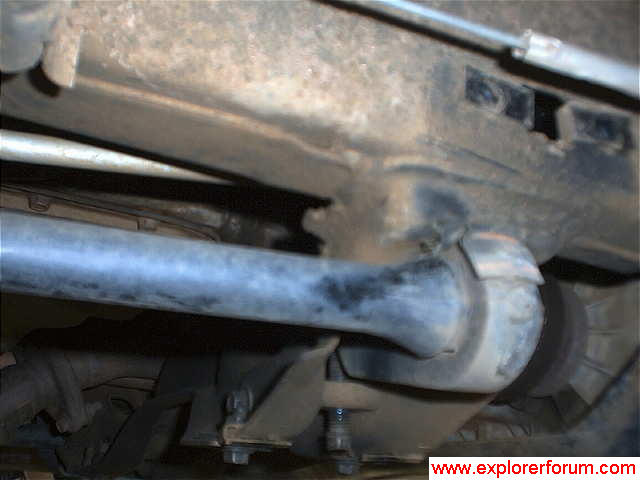

The torsion adjusters were the source of my clanking! I will post pictures tonight of what I found. Basically, the kevlar patch was completely worn off in the middle of the adjuster causing a metal to metal clank with the frame on all bumps. Once I removed the torsion bar protectors (4 easy 13mm bolts) I could see the kevlar getting squeezed out all around the top of the adjuster. It is very easy to replace using a gear puller similar to one pictured in the Haynes manual. Total time was less than two hours and not one skinned knuckle :)
OK, here are the pictures:
Here is a picture of the driver's side torsion bar adjuster once the shield was removed. If it wern't so blurry the kevlar patch could easily be seen squeezing out.

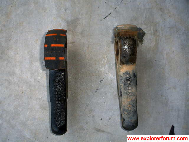

Here is a picture of the new adjuster along side the old one. Look at the old one and you can see the kevlar isn't covering the surface anymore resulting in metal to metal between it and the frame.
The next picture is the gear puller I used to remove the tension on the torsion bars. It made the job very easy!
Once I got the driver's side replaced I took it for a ride. The noise occurance was about half what it used to be and I couldn't feel the clanks under my feet anymore but could still hear a clank. It was back to another Ford dealer to buy another torsion bar adjuster for the passenger side. The next picture is what I found on the passenger side.
It looked just as bad as the driver's side. I have about 67K on my '97 and have had the clank for probably the last 10K-15K miles. I can now say all traces of the clank are completely gone! The torsion bar adjusters part number is F57Z-5B328-A (at least on my '97) and they cost $23.12+tax apiece. They took just less than 2 hours to replace and was an easy one person job. Not bad to get rid of the clanking :)
