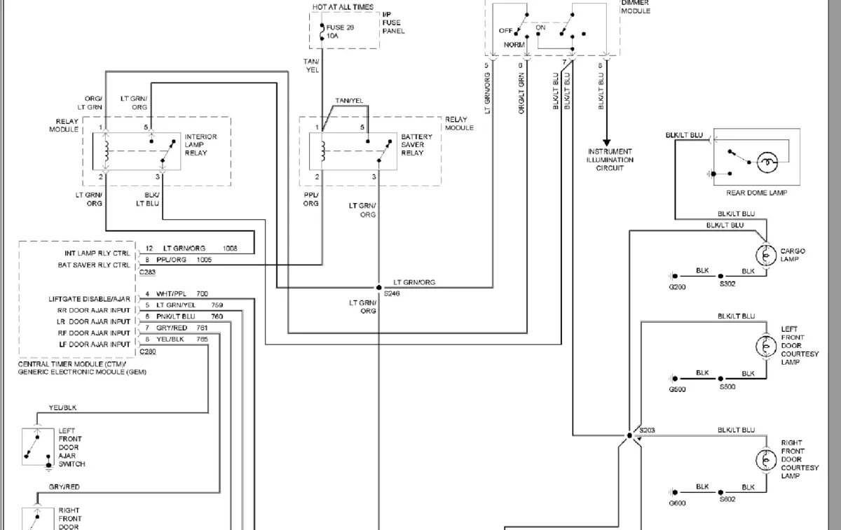

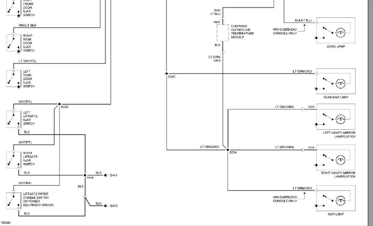

Hi!
I did headliner repair and after I got it back, my central lamp refused to lit when I open the door.
Only front and door's worked.
Then all the cabin light stoppd working.

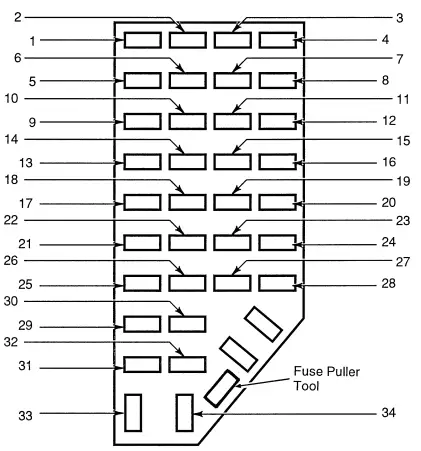

1. Is it a fuse and which one?
2. What's wrong with central lamp. Why it's not turns on when I open the door? I screwed all three screws...
