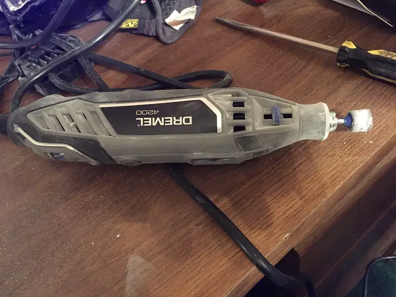

Alright, so i'm mimicking my quad setup, but I'm rearranging a few things this time. Mainly the position of a lot of the leds for a cleaner look. So first things first, one must first take the headlight apart, sorry I didn't take any photos of it, but I set my over at 220 degrees and baked the headlight housing for 9 minutes each. Use a flat head screwdriver to pry them open and remove the lens. I then spent time removing the factory glue from the lens and housings.
Next I popped the bowls out of the housings using a flathead and by applying pressure slowly to each clip until it popped off. The turn signal bulb can be removed by simply unscrewing the phillips head bolt on the back of the housing.
So here comes the fun part, and that is removing material from the bowl to make room to fit the projector through. I bored out the H13 mounting points and inner ring to make the spacing wide enough to fit the Projectors bulb mount through.
Realized the hole wasn't wide enough so i bored it out some more.
Next step was test fitting the projector again and then test fitting the shroud. I had to trim the length of the factory bulb seat down so i could then mount the projector.
Trimmed
