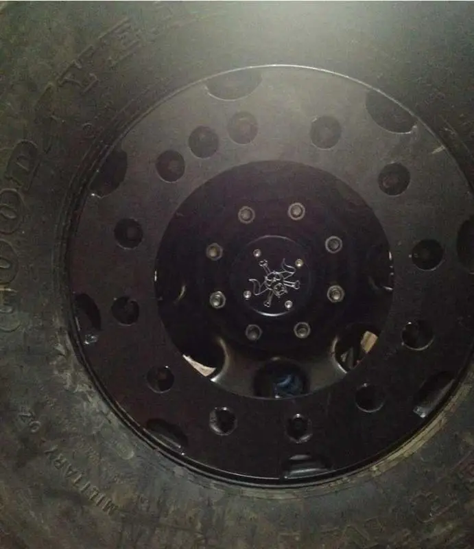

Pros: double beadlocks - locks both sides of tire to rim, cheap compared to alternatives, beefy, easy to mount/dismount tires
Cons: HEAVY, 16.5 rim size severely limits tire choices, large amount of backspacing in stock form and may interfere with stock steering on knuckle and makes the hubs stick out making them vulnerable to damage, 8 bolt versions the lip bends easily - needs rockrings
Here is some info on the sets I have built: http://www.explorerforum.com/forums/showthread.php?t=164206
[MENTION=2069]Randall[/MENTION] uses them on his first Gen with 1 ton axles
Agreed with the above. Pretty much needs to be re-centered to save your hubs. Recommend the 12 bolts. Another con - prone to leaks.
