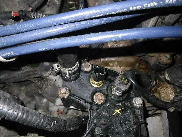

I have an '02 XLT and it developed a coolant leak today. The check engin light came on while on my way home, but the temp never raised. When I looked at it after there was coolant all over and when I squeeze the main hose, it sprays out between the upper and lower thermostat housing. I have been searching the forum and that lead to a few questions. Is it weird that the temp sensor stayed normal, but the check engine light came on? Should I assume it is a warped lower housing or could it be just a O ring and a new one with a bunch of thermostat gasket maker with solve the problem? There are 2 sensirs on the lower housing and one is unplugged and I can't find a line that would plug in there. Normal or is that the cause of the reading not changing? The lower housing is not leaking from the bottom and I am confused on if a warped housing causes the leak on the bottom, top, or both. Sorry, a lot of questions, but I planned my first road trip in the Explorer this weekend and of course that is when this all happens. Thanks in advance.
