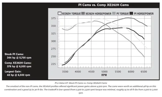

I did look into the Comp Cams XE262AH and almost went with them. I was able to find a dyno plot online from the
DIYFord story and saw that the XE262AH worked well above 4,600 RPM, but the gains were fairly minimal below that. The XE262AH may be a great cam for a lighter vehicle, but in my mind, a heavy SUV would want more torque.
