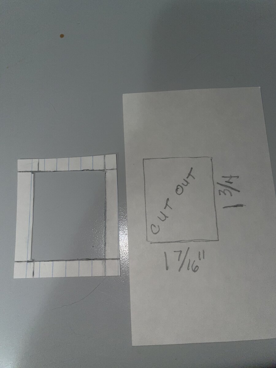

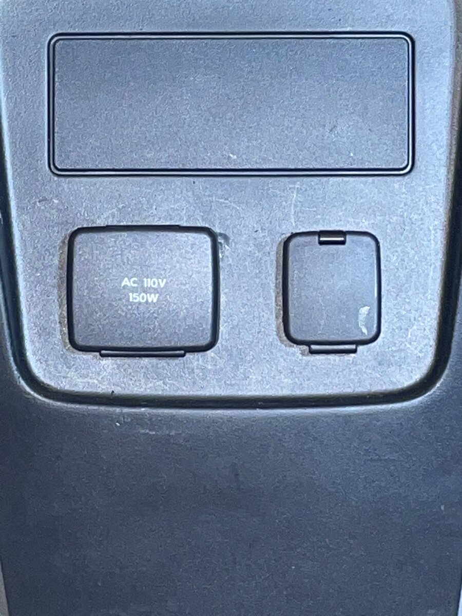

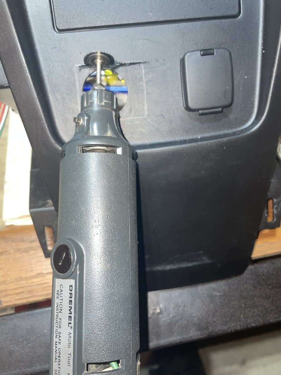

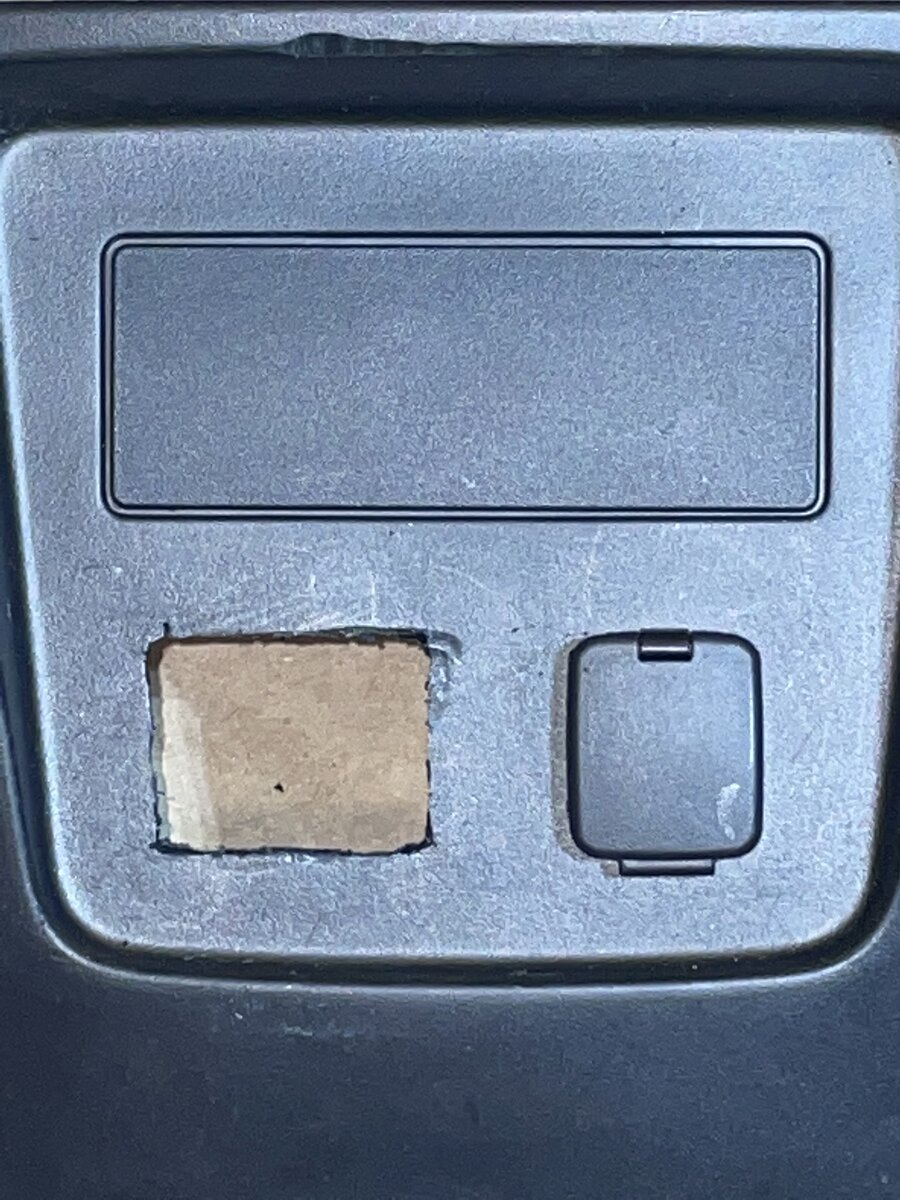

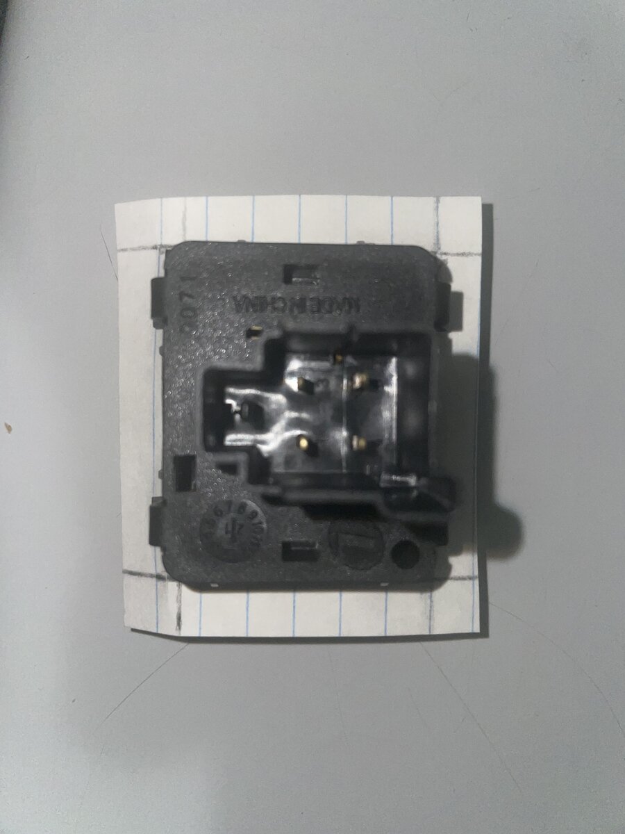

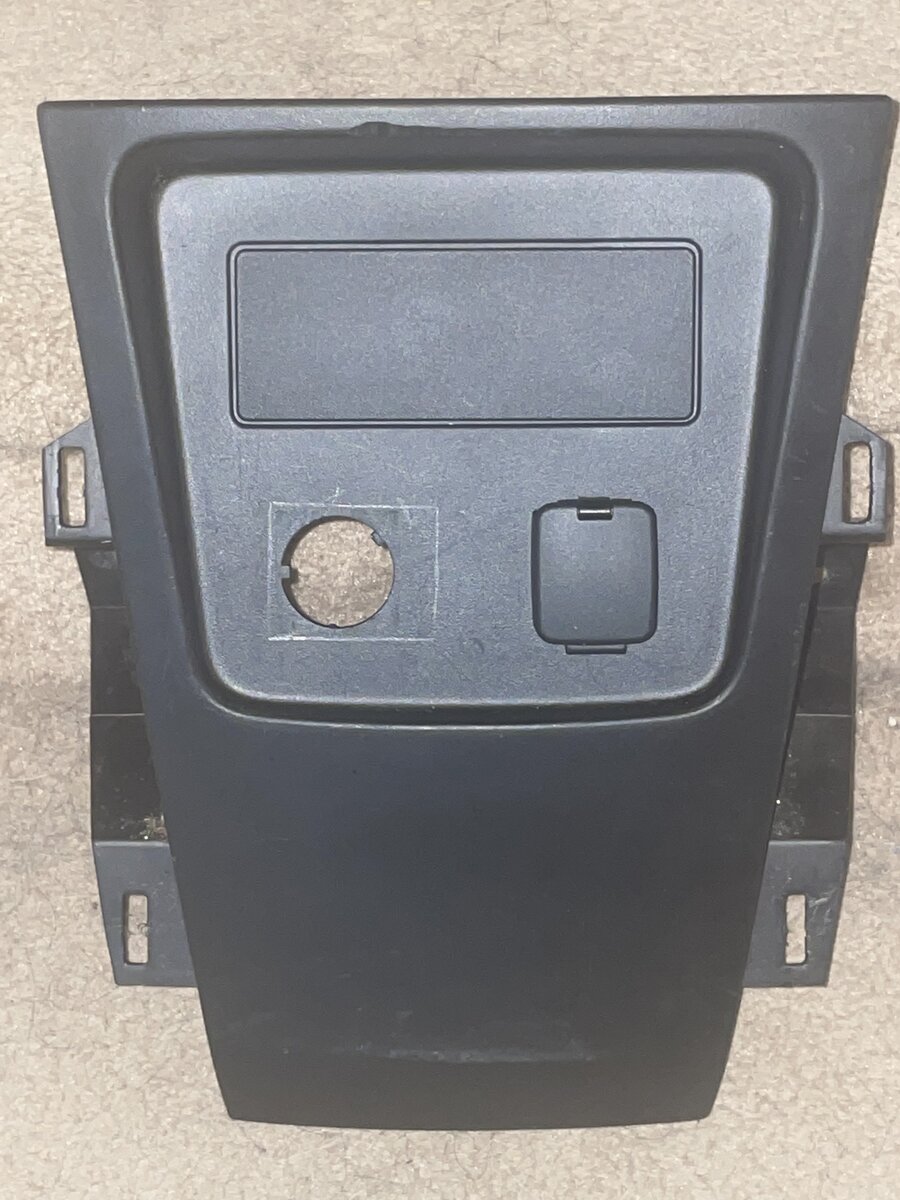

I removed the panel with the cigar lighters attached and purchased the 110V/150W receptacle. I plan on running #8 gage wire from the battery through the channel in the back to the troth just behind the back seat. Then put a 1000W dc/ac inverter in that area with a battery cutoff switch before the inverter. Then #12 wire from the inverter to two outlets. The one in the front and one in the back. You will need to park the vehicle get to the troth and switch the power on so there is no accidental power left on. I am also going to have a switch for the power to the spotlights so nobody can play with them. It will be run off a relay and one of the switches on the steering wheel. The reason I put the pics up is so that you can also get the dimensions and how I cut it out! Slight boo boo on the top right side when I slipped with the grinding head to de bur! I will be installing heated seats in the summer and will put the switches for those in the rectangle panel above the 12vdc receptacle and 110vac receptacle. Between the two I will install a USB charger.
