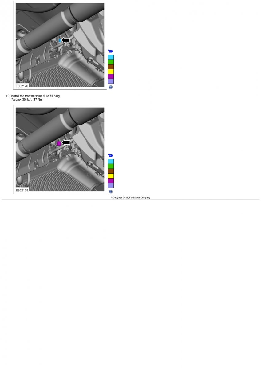

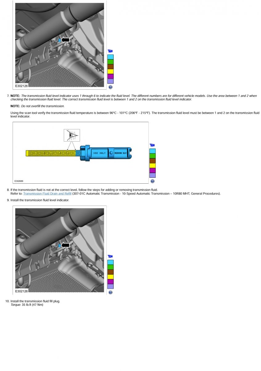

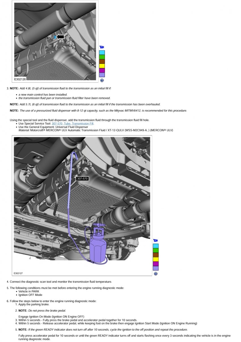

I am looking for the transmission fill volume and procedure, as the dealer changed my valve body, and left me low, 3.7 liters, on a 19 liter fill requirement. Do you have access to the 2020 Ford Explorer workshop manual WSM fill procedure and volumes after a throttle body change? Any suggestions? Thanks!
