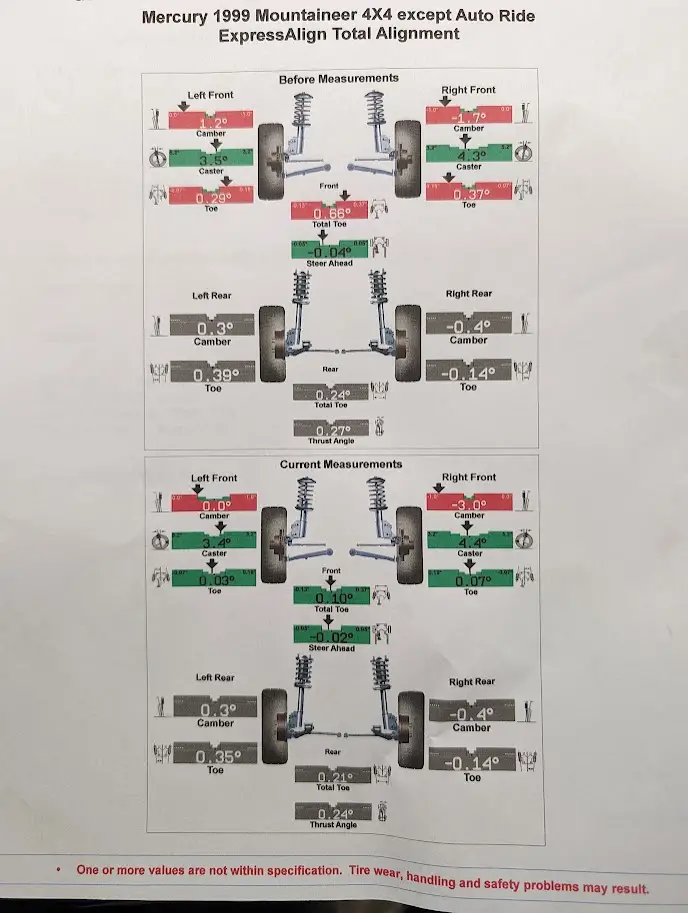

I finally got the rig back home after the alignment (delay was no fault of the shop, I was out of town) and I'm a little confused. As expected, camber and toe were both out when I dropped it off. They adjusted toe and got "into the green," but now my steering wheel is slightly turned with wheels straight ahead (was not like this before).
The mechanic also told me they couldn't get the right side camber any closer to spec and that the UCA adjustment was maxed out. But it was closer to spec when I dropped it off than it is now and I looked at where the camber bolts are now and the eccentrics are further in than before -- definitely not maxed out.
This is a local shop which I've gone to before and they have a great reputation. Am I missing something though? It seems to me like they were either confused or the tech who did the alignment told the mechanic who I talked to some things that were less than true. I've never used an alignment rack before, but this doesn't seem quite right to me.
Take it back. Wheel centering is a big part of doing what they were paid for. Point out the camber adjuster reminding them what they told you. They should not have returned it to you with that readout. No excuses
I agree
It was likely taking too long on the machine and once they had it near the green in the acceptable zone they sent it
Get a better tech on your truck who is more familiar with these suspensions and the equipment and they should be able to get it closer
The wheel should be centered, this is a simple adjustment, aside from a solid axle ford these rack and pinion front ends are the absolute easiest to center the steering wheel on it literally takes 2 minutes
They should have done a road test and centered your wheel afterwards
This is the number one thing alignment customers will come back for? Silly not to do it correctly the first time, now they have to do it again
Thanks, guys. I don't want to be a jerk about it, but I'm also confused why I paid $140 and it's really not that much closer to spec overall than what I did on my own with 15 minutes and a bubble level. Seems odd that they struggled more with a stock height truck than my old shop in Milwaukee did on my Sport after the 2" drop and coilover conversion.
Hopefully they take care of it, if not, I'll just get my angle finder out and adjust the right side myself...and stop going to this shop.
