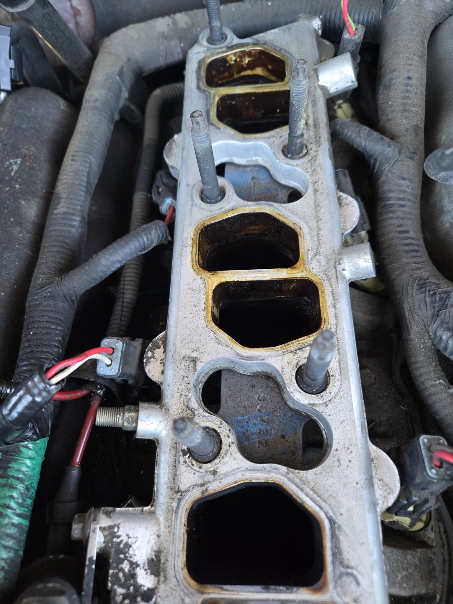

Hello all,
Several months ago, I noticed our Explorer had a mildly perceptible rough idle. This coincided with the check engine light coming on. I hooked up our OBII and got the p0401 code. Not being fantastically patient enough for systematic component checking, I replaced the EGR vacuum solenoid and the DPFE sensor and hoses. No change in the idling, so I replaced the EGR valve. Lo and behold, the rough idle got *worse*, but the 401 code was gone. However, there was now a P0402 code.
I had to let the problem lie while I took care of some issues with our new house (installing a new main water line and doing a full repipe, among other things). Lousy weather and the need to replace the hood struts also kept me away.
With the rain and wind finally over, I fixed the hood was ready to get back to figuring out the Explorer.
I hooked up the OBDII once again and found new codes! in addition to the P0402, I now have p0171, p0175 and misfires (p0301, 303 and 306)! I did vacuum leak test with a smoke machine and found nothing wrong with any hoses, etc. BUT, there was smoke coming from the IAC valve itself, as well as from where the throttle body sensor connects to the throttle body. I replaced the IAC valve, but could not get the screws for the throttle body sensor to budge and left it for now.
There is also a loud, intermittent clicking when idling. This occurs whether the A/C is on or off, and vanishes when accelerating/driving.
And, this is where I am at. I haven't yet done another leak test to check the IAC valve.
So, any advice on which direction I should go? Any help is appreciated.
