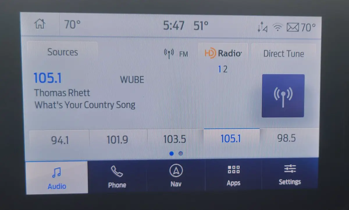

It was in the ACM module as "HD Radio System". Mine was disabled, so I enabled it and then went to a local station the I knew had an HD signal. After a few seconds, the HD icon popped up & turned yellow and gave me the option of channels 1 & 2.Where in Forscan did you find it? I haven't played much in it yet on my Explorer, but we're been using it on the Ranger. Is it in the BCM section?
