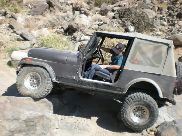

This is my wife's 1984 cj7. She bought it when she graduated from High school. A year later a car turned in front of her and hit her causing her to roll it on the street. Between her and her dad they spend about two years rebuilding it from the ground up to get it back on the road. I came along and helped with the drive train swap and well it all went down from there
Engine:
1998 TJ 4.0 OBDII
Borla Header
CA smog legal engine swap
Kilby air kit using York compressor
Trans:
NV4500 with 6.34 first gear
Advance Adapter bellhousing
Mix of chevy and dodge parts to allow tcase to bolt up
Tcase:
Stock dana 300 with 4:1 gears
Axles:
Front Stock dana 30 4.10 with a traclock
Rear Stock AMC 20 4.10 with detroit and one piece axle shafts
Tires:
33" Goodyear MTR
Aluminum 15x8 rims
Suspension:
2.5" rancho lift springs
1/2" longer shackles
1" body lift
Protection:
Warn Rock sliders
Kilby gas tank skid plate
6 point roll cage
Other:
9000lb Warn winch
Trails we have done with this jeep:
Rubicon
Dusy Ershim
Aftershock
Clawhammer
Bullfrog
Truckhaven
and countless under lesser known trails around CA.
