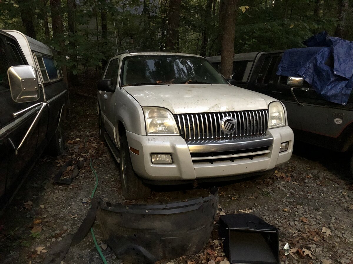

I destroyed the front end of my ‘03 Mounty with my ‘79 F250 a couple years ago. As it’s the Pearl White, it’s been hard to find hood, bumper, fenders.
Then an ‘06 Mounty popped up on FB for parts AND it was Pearl White. So I bought everything off the front end, for $100. Wait, that included the rear hatch as well.
So heres the deal, if you want a “4th Gen” Mounty front end on your “3rd Gen,” all you need is the bumper and the grill. Everything else is the same.
edit: picture added. Not all put back together yet.
