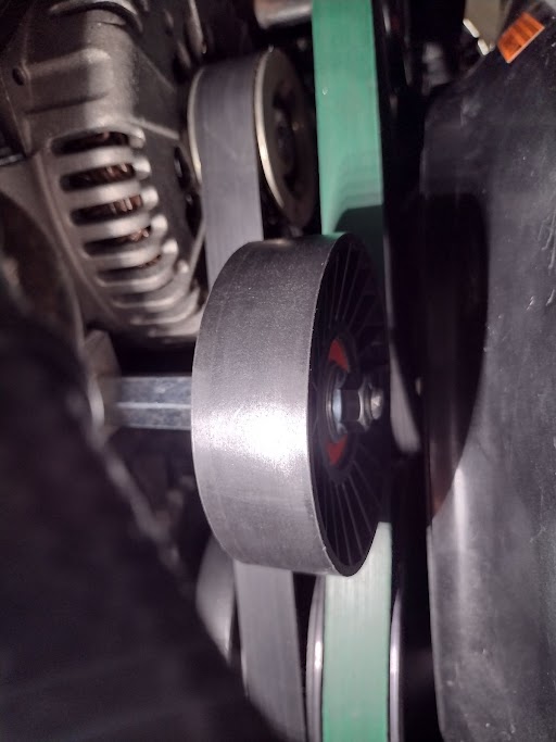

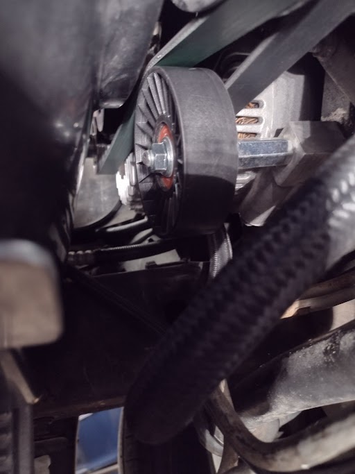

Obviously, I think we all expected to see a bigger/better result from the XB-1a. At the moment, they do not feel there is a boost leak. They think "maybe" this could be related to belt-slip with the 2.7 pulley and we are further investigating this. Belt tension is going to be checked and additional pulls with the 2.7 and 2.8 pulleys will be made with a full boost level recording (since the dyno boost gauge during the tuning pulls wasn't functioning consistently ) and see where we are at that point.

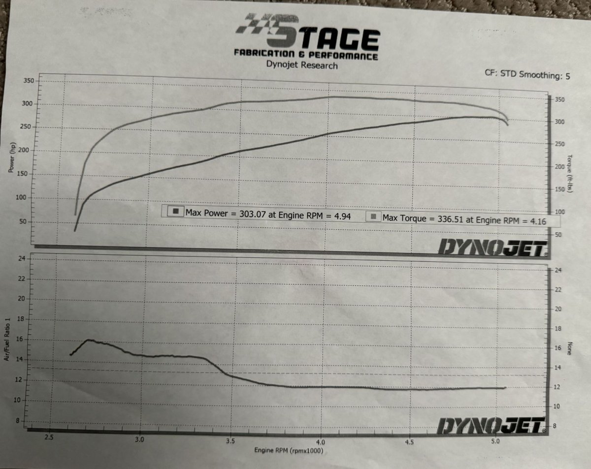

- RWHP 303.07 - Torque 336.51
- This was the last dyno of the BD-11A before the rebuild by Jon Bond Performance and original bearing failure.
- I was running the following pulley combo for this pull
- 2.7 (2.65) SC Pulley and 6.5 (6.485) crank pulley
- Stock Impeller, stock belt and stock bearings
- Pull cutoff RPM was ~ 5000 rpm
- Max blower rpm 36,712 - 37,319
- Boost level observed with this pull was right at 6lbs

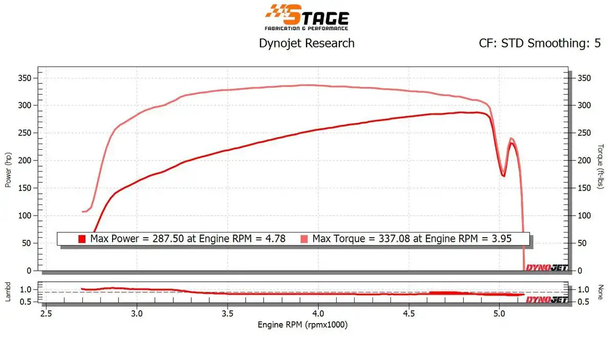

- This was the 1st dyno after the rebuild of the BD-11a by Jon Bond Performance
- The following work was done by Jon Bond
- New bearings
- Billet Impeller
- New internal belt
- 2.8 (2.86) SC Pulley and 6.5 (6.485) crank pulley
- Pull cutoff RPM was ~ 4800 rpm
- Max blower RPM 33,195 - 33,985
- Boost level observed during this pull was in the high 5lb range.

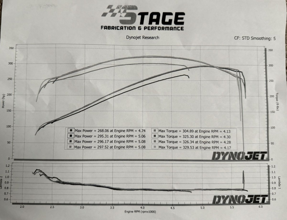

These are the next dyno runs with the new Powerdyne XB-1a and 16 fin MID billet impeller (Si Trim)
- RWHP 268.06 - Torque 304.89
- Pull cutoff RPM was 4800 rpm
- 3.1 SC Pulley and 6.5 (6.485) crank pulley
- Max blower RPM 34642 - 34722
- The approximate boost level observed during this pull was in the 4lb range
- The next 3 runs were with the below SC and crank pulley combos
- RWHP 295.31 - Torque 325.30
- Pull cutoff RPM was ~ 5600 rpm
- RWHP 296.17 - Torque 326.34
- RWHP 297.52 - Torque 329.53
- The pulley combo I was running for these (3) pulls was
- Max blower RPM 46511 - 47279
- The approximate boost level observed during the last 3 pulls was in the 6psi to just at 7psi range
