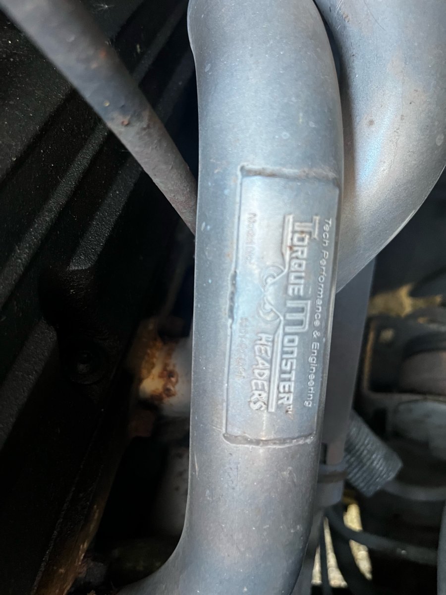

I am in the Torque Monster Header Club!!!

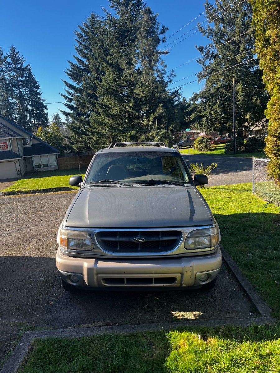

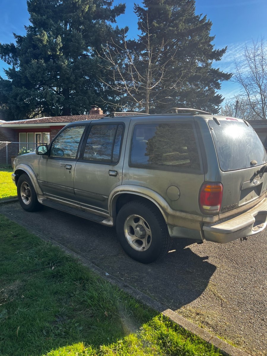

Picked up my donor vehicle today. The truck is dirty and rough, and mechanically well maintained though. Bought it from a mechanic he did the Rockers, Cam, and Header install himself.
It is a 2000 AWD

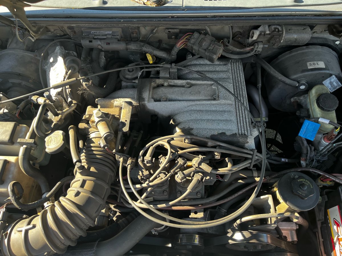

Engine mods:
1.6 Rockers and valve spacers / covers to match. The Engine fill tube leaks from this install and he said there was not much solution for that? But I think I can get it to seal better.
Stock Cam Shaft swapped for Comp XE 258-14

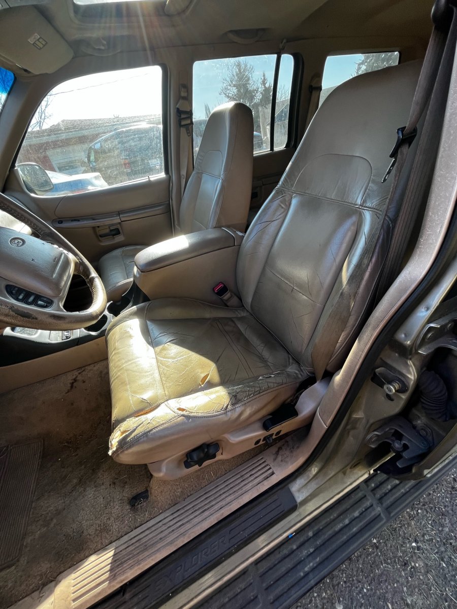

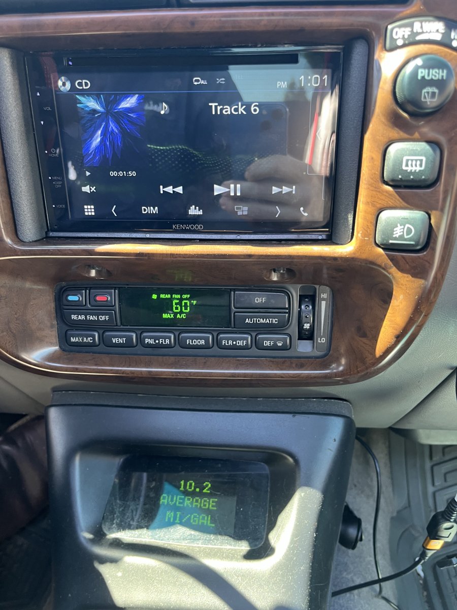

It has the CD-Changer in the console which I am stoked to have now. It also has the 2000 Captain powered seats. They don't have the headrest like my 2001 seats, and don't have power heat but I may repair them and see how they look.

I plan to take all kinds of body molding and most any useable in the future part off of the rig. Then its getting scrapped.
It is a 2000 AWD
Engine mods:
