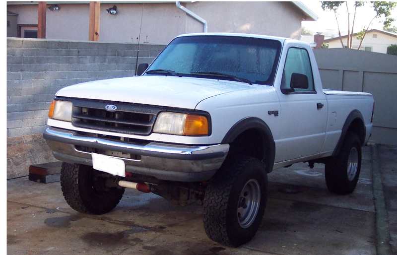

After loosing my last ranger a bit over a year ago I finally got onther one to replace it. The truck I am starting with is a 1993 ranger 4X4 xl standard cab short bed. It is pretty much a bare bones truck. No AC no cruise and a manualt t case. It also has a 4.0 and a 5 speed with 3.73 and an open rear diff. When I purchased the truck it came with a 2.5" rancho lift 31" bfg AT tires on aluminum rims.
I have had the truck around 3 months now and have put about 3000 miles on it sofar. Over that time I have noticed a few things about it. When they installed the lift instead of installing longer brake lines they installed limit straps that limit down travel to about 1" from ride height and also removed the sway bar. They also didnt lift the rear at all and it has a serous case of butt dragging.

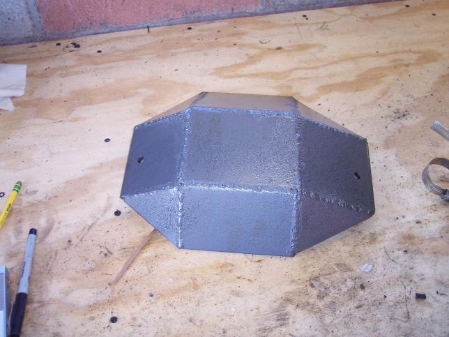

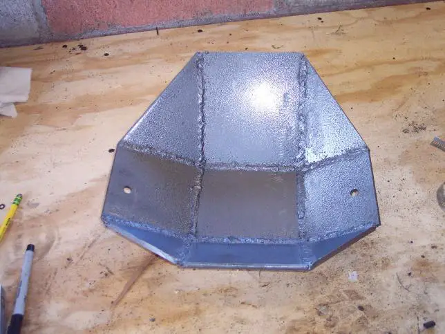

After buying a lincoln 220volt welder I needed something to practice my welding skills on. I decided to build a skid plate for the front dana 35. On my old housing the 3 lower bolts were screwed up from hitting them on rocks that it was hard to get a socket on them hopefully this will stop that from happening to this one. I also developed a leak on the old dana 35 that I couldnt get to seal. I believe part of the problem was from smaking the front diff so many times that the bolt holes became stripped out somewhat and I couldnt get it to stay tight. One time I managed to get a rock stuck on the aluminum housing of the dana 35 that lifted both front tires off the ground. I think this also contiputed to the leak. Hopefully I will get it mounted tommorow and get a few pictures of it on the truck then.

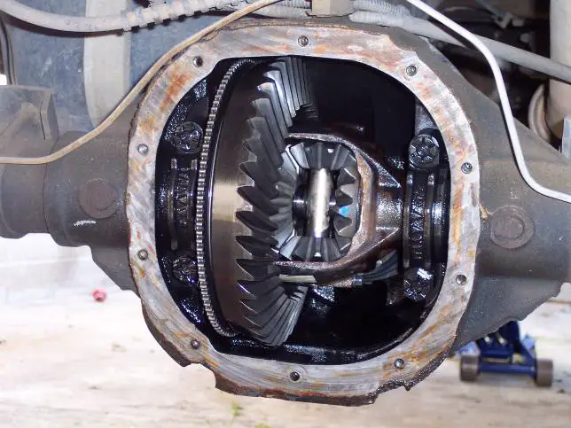

After going to truckhaven this past weekend on the annual forum run and riding with others most of the weekend I needed to do something with my truck. I went on the night run with my truck and in 1.5 hours I managed to need a strap twice get pushed twice some helpful weight bias of RangerX on my rear bumper. I also managed to dent the corner of the bed, crack a taillight and tweak the crappy stock rear bumper I needed some help. After a quick inspection of the truck I found one source of the problem.
So to solve the problem I decided to test out the handy dandy lincoln welder again. Should take care of some of the problems with traction.
Well, at least it is a true Lincoln locker and not a miller or hobart:D
I am planning on take the ranger on about an 800-1000 mile road trip this weekend with maybe some wheeling involved I will see how it does then. I plan on when I get back changing the rear diff fluid and see how the locker holds up. I may add more welds to it then if I see any problems. I also started making a rear bumper out of 2x4 tubing across the back then 2x2 tubing that will run from the rear bumper the wheelwell. Hopefully I will have it done tommorow as well. Still need to figure out where I am going to mount the licance plate. Also taking the rear sway bar off as well.

How does the welded rear perform on the road? I'd like to do this as it's an easy option for a locker, but it's a daily driver so....gotta keep the road manners. By the way, nice project, good luck with it.
Not sure yet how the road manners are of it yet cause i havent driven it yet. In my last ranger I had a lockright and a detroit and both were fine on the road other then a few pops and bangs now and then. This truck isnt really my daily driver as I have a 2004 z71 silverado, however i do find myself driving the ranger more then I thought I would. If I end up really hating the lincoln welder I will go buy a real locker.

Hmm the way you did your lincoln locking you might be kicking yourself later for, did you just fill some of the teeth on the spiders cause in the pic it looks like the spider is welded to the carrier (bad) if i remember right that means the C-Clips are welded in now? other then that it looks good =)
