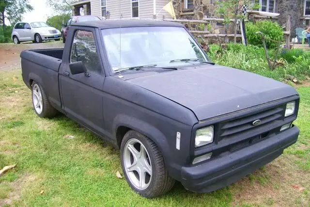

Here is my other ride. Never ending project and probably will never be "finished". lol

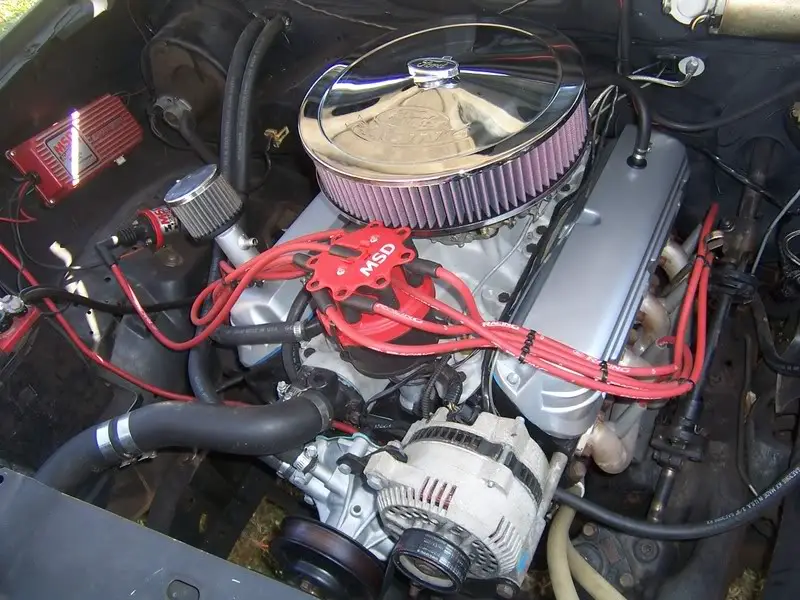

Here is a little run down.
5.0 roller bottom end refreshed
GT40P heads with crane springs and comp roller rockers
FRPP b-cam
Comper Timing set
Weiand Stealth intake
Holley 650dp
MSD Ignition
T5 Trans with pro 5.0 shifter
fidanza aluminum flywheel
FRPP king cobra clutch
Exploder 3L73 rear end

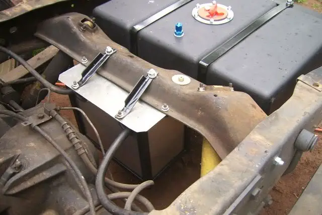

16 gal fuel cell under bed at the rear
battery relocated under bed
Im sure I am missing a lot but you get the idea.
Its not the quickest but it sure is fun to drive. Just keep it between the ditches. lol
oh wow im surprised no one has commented, but that is one super clean ranger:thumbsup: the last 5L rbv i seen did not look that clean, it was more of a rats nest
what other plans do you have in store for it? what colour are you going with or you sticking with flat black?
how far into your rad support is your rad? and also what e fan are you running?
edit: i just noticed it looks like you molded a sploder grill to a first gen grill?
Now that's a ranger I wouldn't mind having :D nice ride man

I want to do something with 2 hair dryers but that will be a good bit down the road. I want to find a 4.10 disc Explorer rear end and narrow it a little bit, and then body work. im going to do the body work and paint it with some good flat black.
The rad is tucked into the core support a good bit. None of it sitcks out past it. The fan is just a universal on from the auto part houses. I need to upgrade it. It will keep it from over heating but it will not cool it off.
The grill is a out of a Aerostar I molded into the Ranger shell.

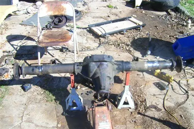

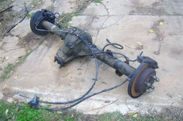

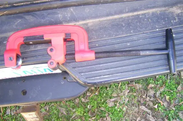

Got a disc 8.8 with 4.10 LS at the junkyard today. Went ahead and pulled the drivers side axle at the junkyard and swapped it out with the shorter passenger side. Going to just cut the drive side tube down and run a passenger side axle and move the spring perches.
The passenger side axle is about 3 inches shorter then the driver so it will get it back to about stock width. Then I can put some bigger meats on it and set the pinion angle right.

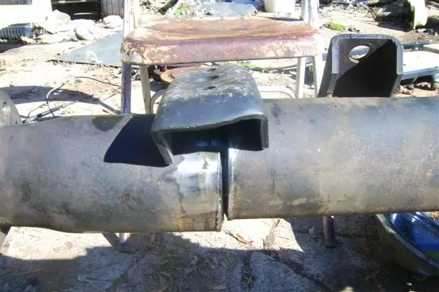

Started tearing the new rear end apart.
Pulled the axles, brakes, backing plates. Cut off the stock spring perches.
Only spring perches I could find locally was for a 3" axle tube. The Explorer 8.8 is a 3.250" axle tube. Just had to grind the corners of the perches a tad and they fit great.

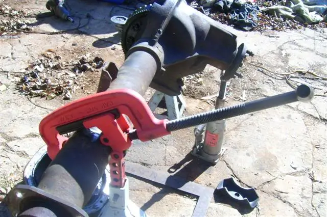

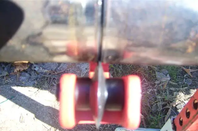

Went to Harbor Freight and got a big pipe cutter. It was only $20 and came with 2 extra cutting wheels.

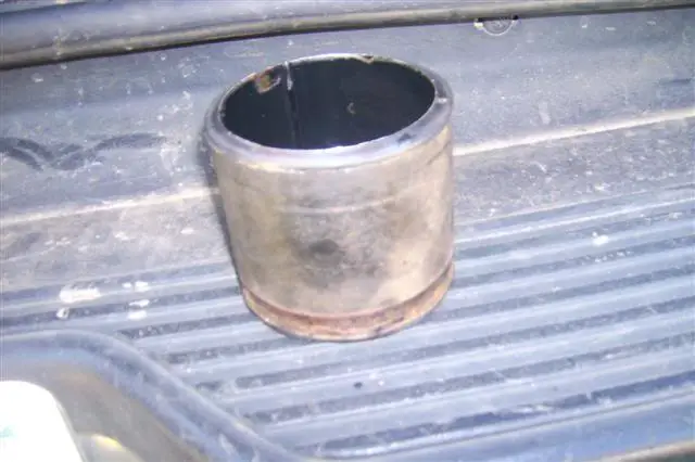

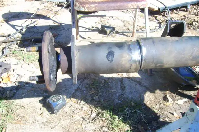

You ave to cut out 2-15/16" to be exact to put in a passenger side axle.
So mark it where you want to commence to cutting.
First cut
Little deeper.
Finished first cut.
Now start the second cut 2-15/16" from the other.
Then thats all the cuts. It cuts through pretty good and quick just have to use some muscle.

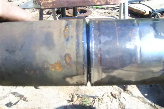

I measured out where the spring pad will be welded on and made my cut/weld joint right between it so the spring pad will bridge the weld and help strengthen it.
Overall shot now.
Piece I cut out.
Now just have to weld it all up and it will be good to go.

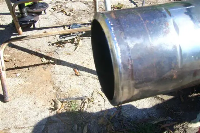

Here is the axle tube welded back up.
Still got to repack the clutches and I got a F150 s-spring for the L/S.
If the sway bar still bolts up ill leave it on if it doesnt line up ill just cut the mounts off.
