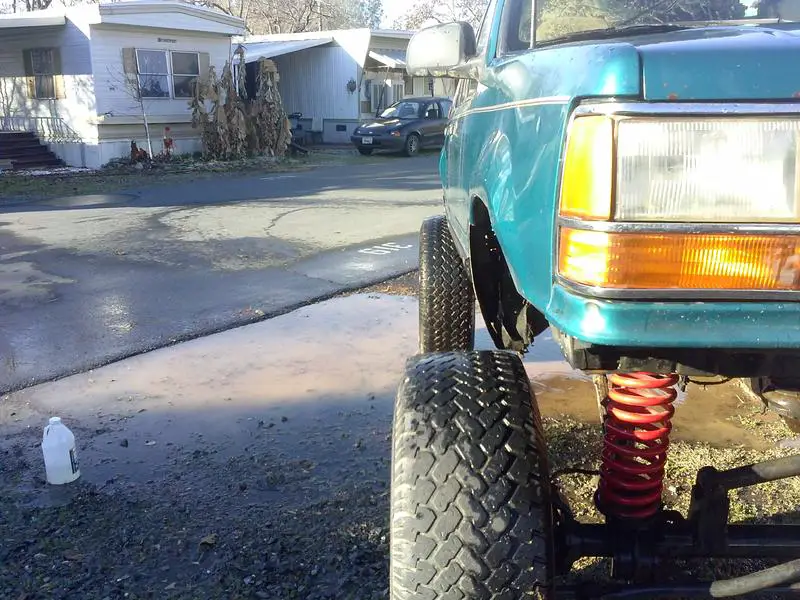

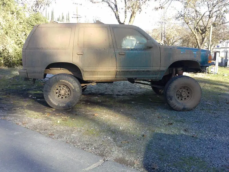

Front
Dana 44 out of 79 f250. $300 with rims
Wild horse 5.5 coils $189
Duff rear coil buckets 2 inches shorter than normal ads 2 inch lift $ 119
7 degree wedges $50
F150 radius arms lengthened 12 inches with ballistic joints $50+ $30
Newer super duty draglink $ 22
Trac bar and bracket ballistic fab $75
Stock chevy brake lines $10
Caliper rebuild kits $20
Rear
Dana 60 full float from same truck $300 with rims
Soa with stock leafs $22
2 inch lift shackles $0
1310-1330 rear ujoint $20
TOTAL SPENT 1186 PLUS SOME MISC THINGS
Im done just dont have a front Driveshafts and i think thats it also. This was built on a teenage budget so no fancy. Things yet.
Thanks go to fourosprtand randall for solving my problems
