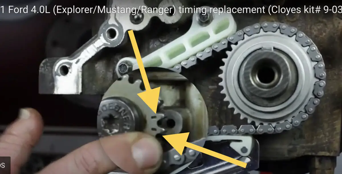

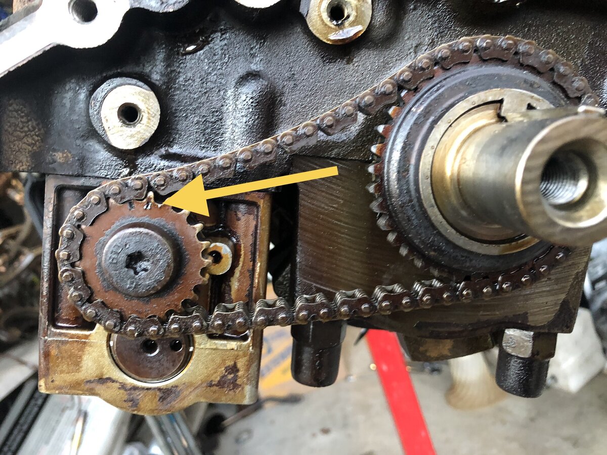

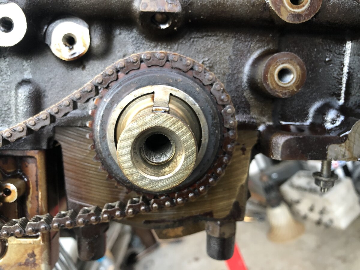

At no point in replacing the chains does it mention counting the links on either side.
So the rear passenger chain and sprockets go on, just as they fit, and are only held to the cam/crank with the clamping force of the bolts. Ie. no woodruff key or notches in the gears etc.
The front balancer shaft chain seems to just go on with no link count either.
This just seems crazy. Is it just me that thinks this is weird? With the 4.6, you have marked links.
