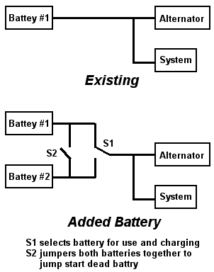

I've read where some users connect spare battery to engine battery with jumper cables to jump start engine.

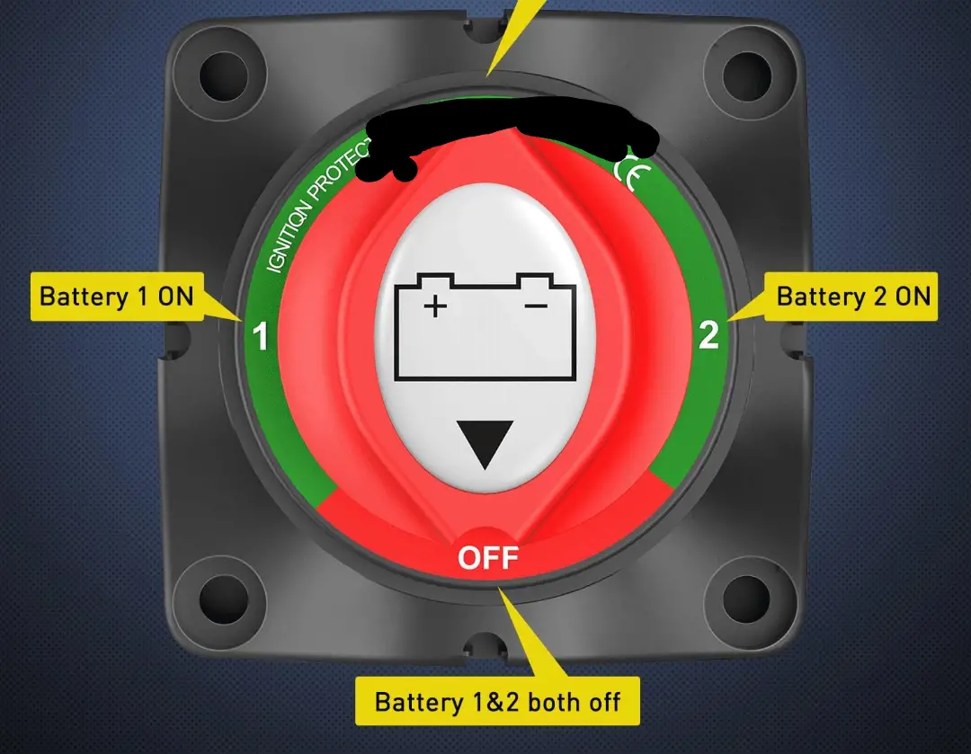

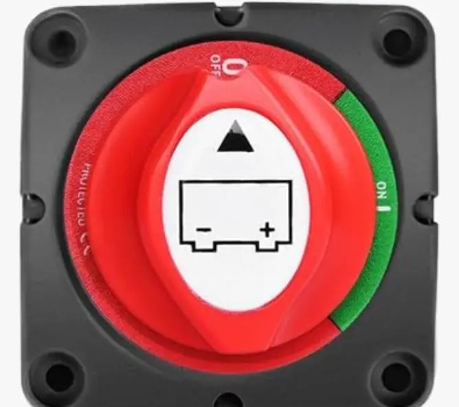

I found a 3-position 300 amp switch - battery 1, off, battery 2 for battery use/charge select, and a 2-position switch - on, off for dual battery jump starting (drawing attached).
I could find room for a size 34 or 35. Since I'm not using a solenoid or electronic dual charger, the batteries don't have to match.
