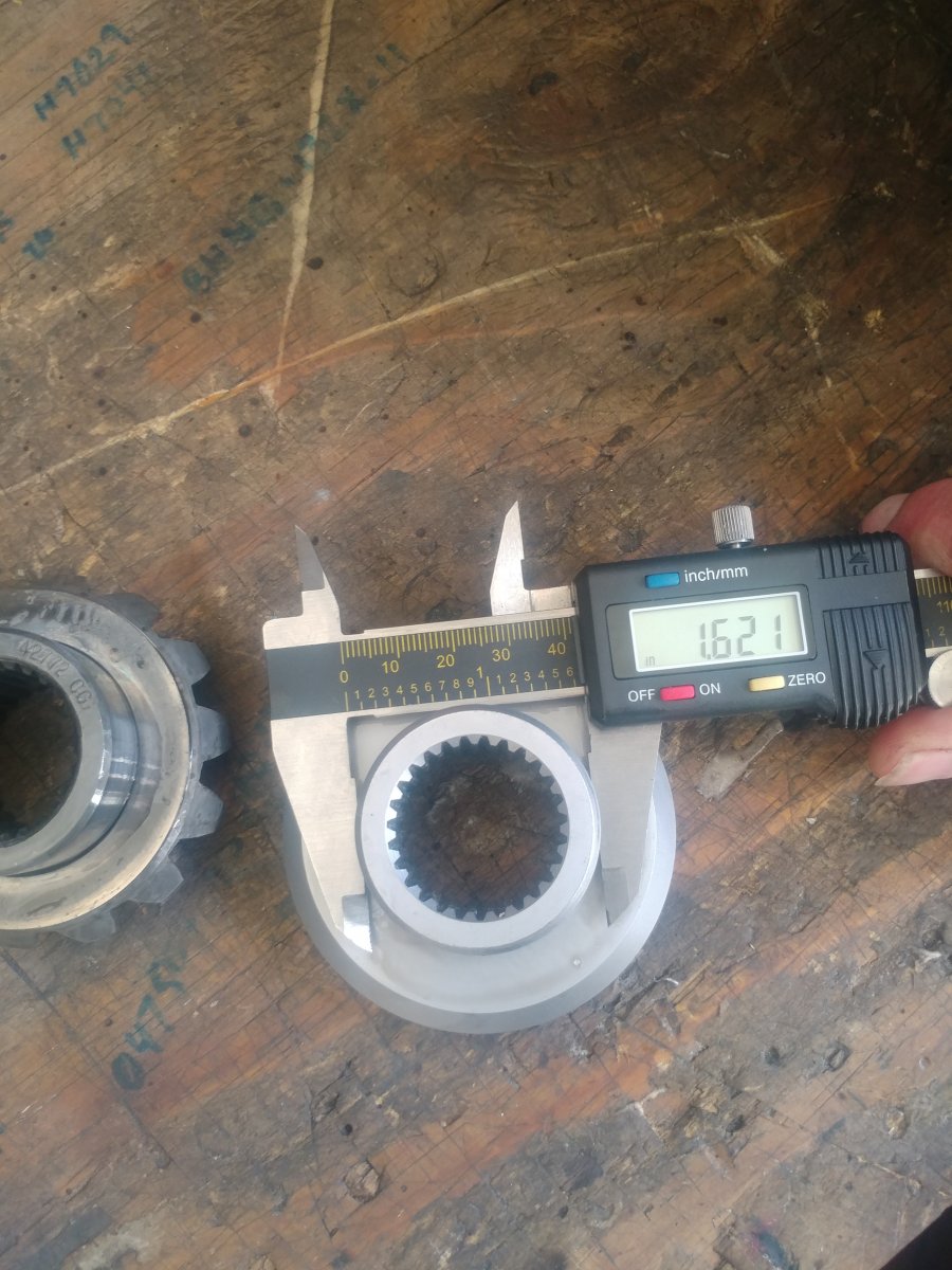

Hey everybody, I've returned after a long time away. Can't believe the site is still up and running. So much good info here. Anyhow, I used to have a 94 explorer sport (see sig) and I saw a 94 Navajo for a deal I couldn't pass up! $500 for a manual with manual transfer case. I'm working on getting the thing back in shape and driving and it's going to be a trail rig only. I'll still be driving it to the trails, so it does have to be road worthy. This is a total budget build and I'm looking for the cheapest front auto locker out there. I know the LockRight is part number 2311-LR for the front but I think that's for the 1995+ trucks. I can't seem to get there website to come up. I found a company called Nitro Gear and Axle that seems to have a knock off of the same locker. The problem is they show 2 on their website for the D35 and both say they will fit the 1991-1994 explorer. When I do a search for 1994 explorer it comes up with the 1.625" side gear option. My question is has anybody used the Nitro Gear and Axle locker and do you know which is correct for a 1994? My truck looks to have a 3.73 LSD out back that was swapped in (has the 3.27 axle code on the door) and it has 3.73 front gears as well. How do I know what the side gear hub size is? Was that the difference in the carrier when you had to switch to a larger one if you had 3.55 and smaller gears and wanted to go bigger? The two lockers they list have either a 1.625" side gear or 1.56" side gear. Yes, I tried the search function and didn't find anything. Thanks for the help, it's good to be back! Can't wait to hit the trails again.
