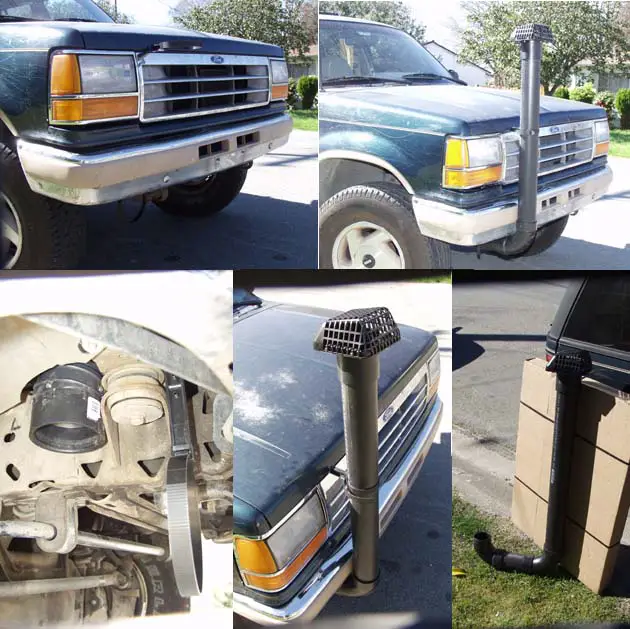

Here's the pic of my snorkle. The first one is of the two hoop clips that I use to support the snorkle when it's on. The next pic is of it on. The botton left pic shows how my newly directed air intake comes out under the front passenger side of the car. The lower right one shows the removable part of the snorkle that can be stored when I'm not crossing water, which is most of the time.

Here's how it looks connected under the car.

Zenius- that looks good, but aren't you worried about crossing a mud pit or something and slamming the front bumper in a hole and cracking your snorkel below the water line?

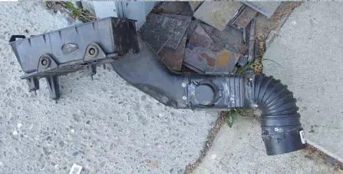

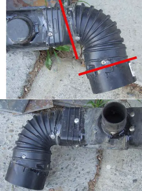

How does this connect to the airbox? What did you do to the airbox to make it water tight?
From the pics, it looks like you did some cutting and have made (during non-water crossings) a cold air intake. Can you show some pics of the airbox, possibly removed? I would be interested in the cold air modification if nothing else.
Here's my airbox pictures. It looks messy at the seals but I didn't want any leaks and no one can see it anyway. The red lines show where I cut the 90 degree elbow.
I don't have to worry about hitting the snorkle into the ground in mud pits because there is no mud in CA! I'm always amazed at how different the wheeling is on the West coast from back east and how different we set up our trucks. Any other snorkle questions?
