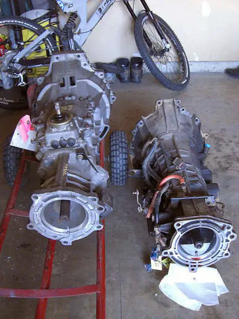

Just for the record, I hate fixing the clutch parts on m5od's. It was so much easier just to replace a failing automatic than fight with all the assorted parts of a manual :fire: Morgan's flywheel clutch plate has a ton of heat stress cracks and there are hotspots on the clutch disc but I can't afford to replace them right now. I broke out the mini grinder and used some strong cookies to sand them down, and had to replace the pilot bearing and slave cylinder again. Apparently there's a rubber 'check' boot on the bellhousing that I should have.. but I don't, so all the mud and water from 2 years worth of 'wheeling has done its damage. I'm off to the junkyard today to try and score a new booty. ARG MATIES! lol. Hopefully my boss won't kill me on Monday since I couldn't get everything back together in the 4 hours I had to do this and had to leave Morgan on the lift at work :eek:
Correct way to remove your transmission:
Incorrect way to remove your transmission:
You'sa talking about the two rectangular holes at the top of the bellhousing (on the left transmission in the image below) ? Cauz I dont have a boot either but sounds like I better put something there to cover it!
If im correct there are not any rubber boots for the top two holes there IZ. There is one on the bottom left side of the bellhousing. I think its on the left
