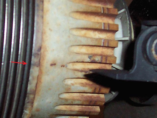

The head was repaired and sent back to me with marks to line up so the cam timing was right but the mark came off the cam.
So, number 1 cylinder is on the passenger side of a LHD vehicle toward the front of the car?
TDC is determined by the notch on the pulley lining up with the crank sensor?

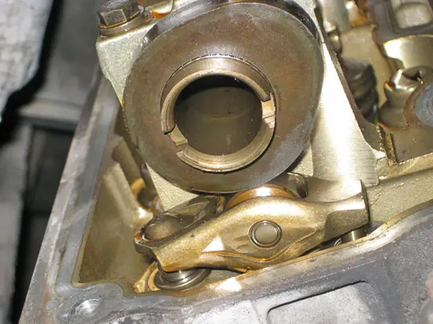

With number 1 on TDC the other cam should have the slot at the rear below the centre line and parallel with the cam cover gasket surface of the head.
