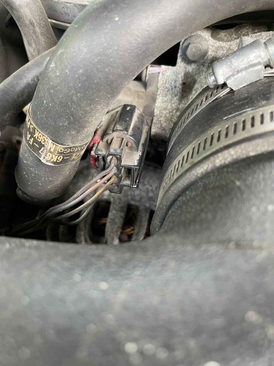

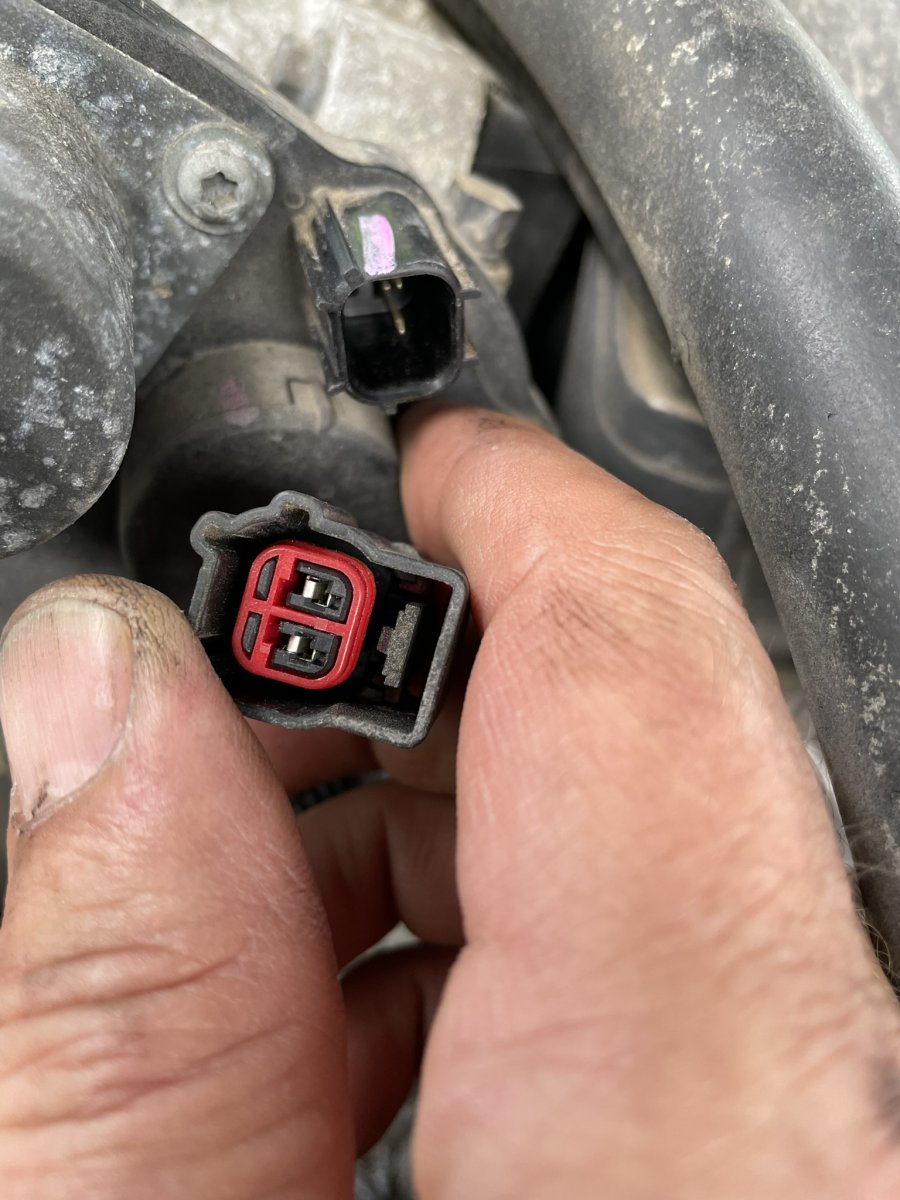

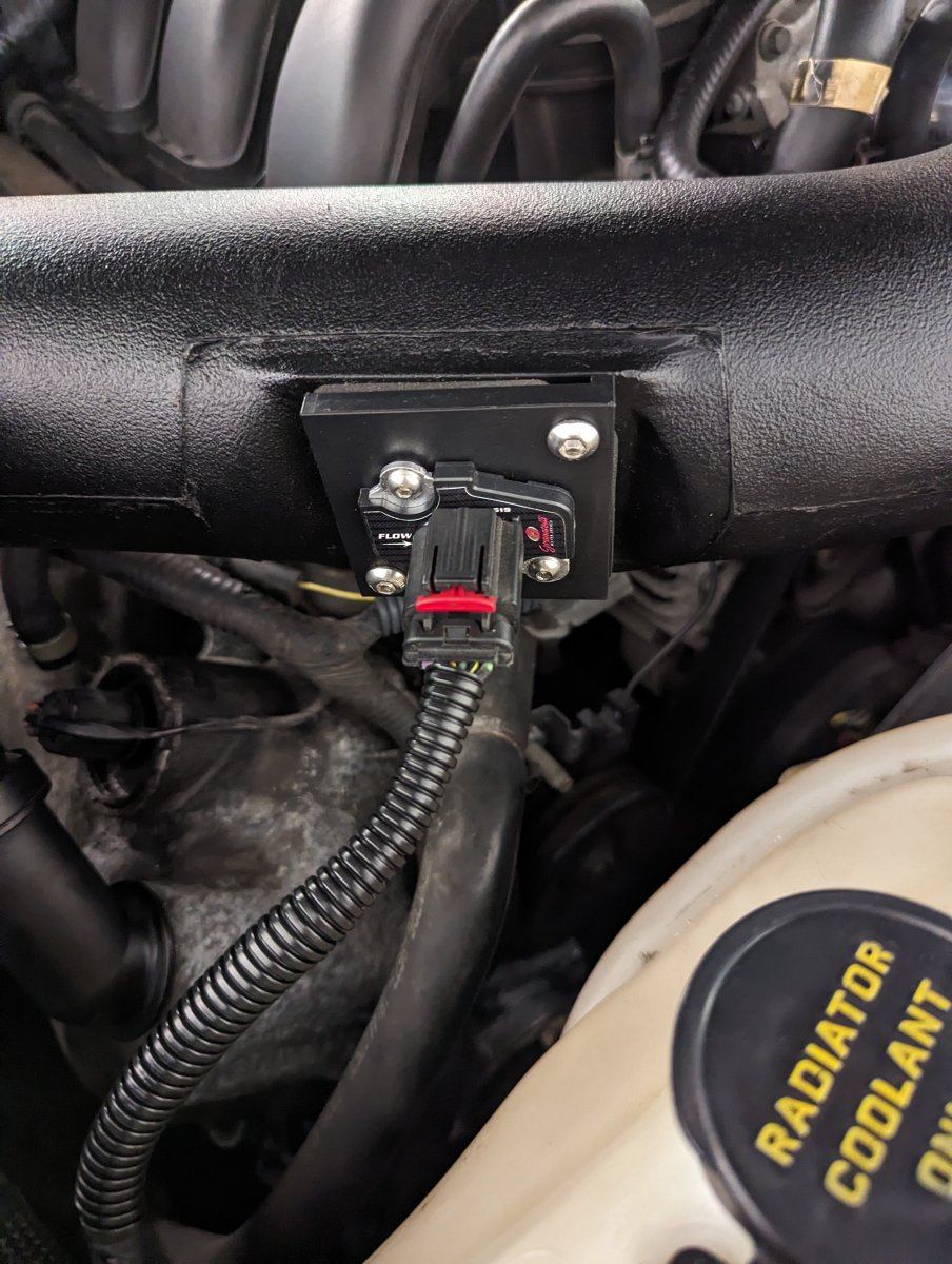

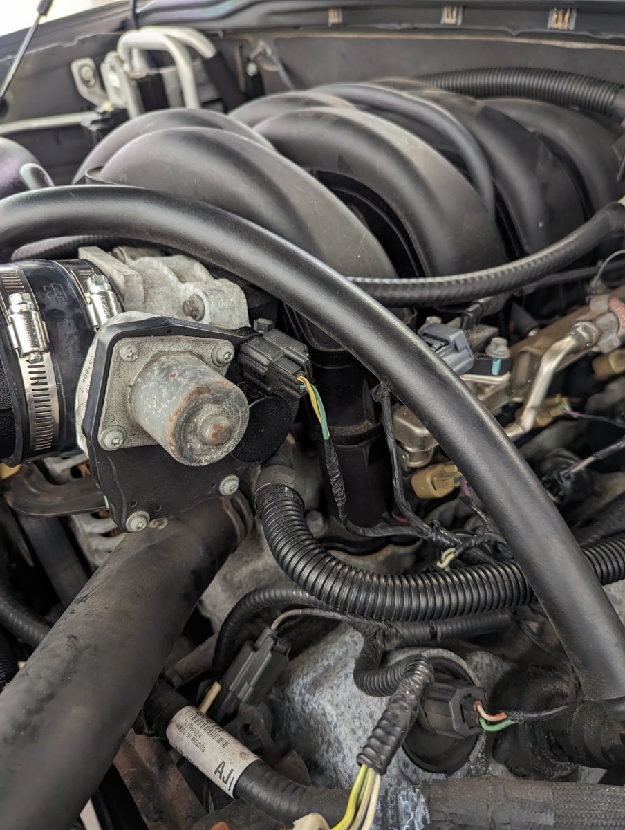

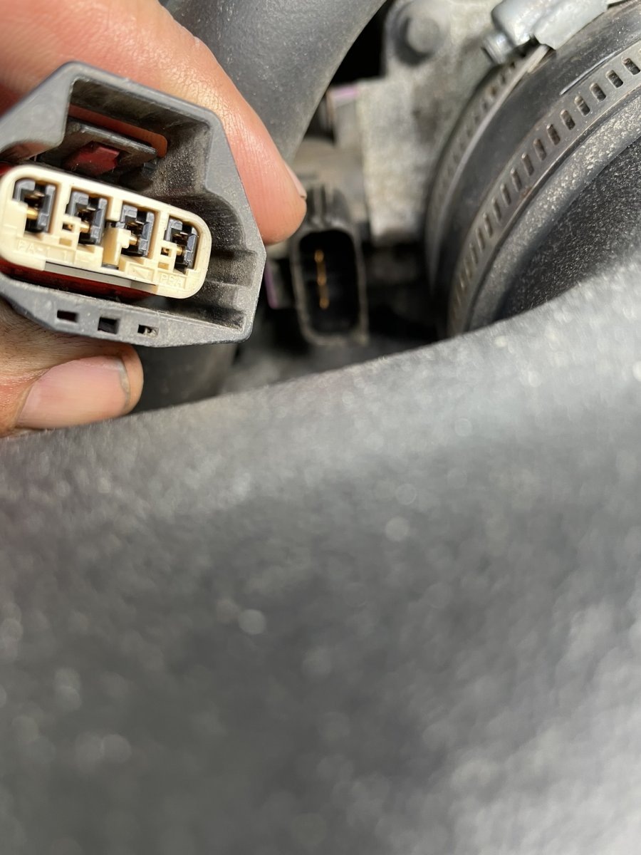

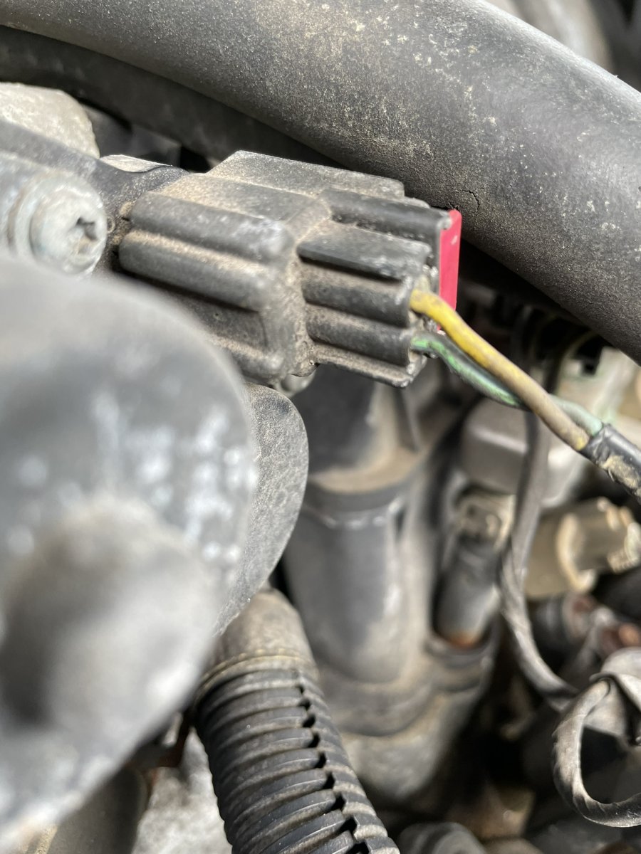

Looking for some input and help. I have a 2007 Sport Trac with the 4.6L V8 and about 78k on the odometer. Previous owner replaced the exhaust which has a good sound and decided I'd bite the bullet and buy the K&N air intake (57-2573) to compliment. After being installed a couple of weeks and a couple hundred miles the check engine light decided to turn on. As soon as that happened, the transmission also started acting jerky and shifting rough, eventually throwing the wrench light on the dash. Checked the ODB2 for codes and get P0171 and P0174. Figured with the age of the vehicle, I'd just replace the stock FoMoCo MAF sensor. Disconnected the battery and installed the Hitachi (MAF0012) brand. That worked well for about a week, and then same symptoms as before. Before I get too carried away on throwing more money and time into this thing, I thought I'd post here to see if anyone else has had a similar experience. I've been looking through all sorts of forums where people claim that the problem is an oiled filter fouling up the MAF sensor to needing a tuner or other upgrades. I'm okay with spending a bit more and doing a few other bolt on upgrades as long as it's dependable.
