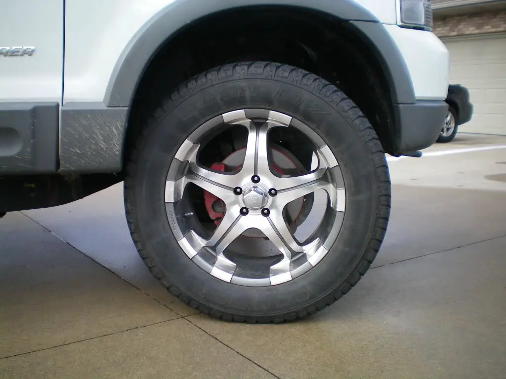

well i decided not to buy brand new rims, so instead i picked some up for $375 for four 20x8.5" +18 off set MB Bruzers with 275/45r20 General Grabber UHP's. The 275/60s will be put on in the spring. The clear coat on these rims is shot, so i'll have to get them blasted and painted, or powder coated (despite how many threads i've read saying PCing will over age the rims..) Considering the price, i'm contemplating buying 275/60s andd running these rims through the winter.

Updated Pictures. 275x60r20 (33.03x11.06) Cooper Zeon LTZ
Looks great, as usual. Good choice of rims and tires.
Outstanding!! :D
