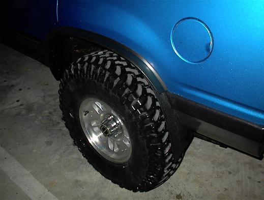

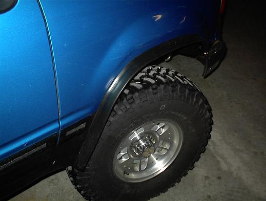

FENDER FLARES
Okay I mentioned there was 4x4 traps being seen around where I live. Apparently it is more accurately a trap to catch large trucks, but they are pulling in lifted 4x4 vehicles as well.
I have been told that a "passenger vehicle" which is what I am classed as, cannot exceed a bumper hieght of 22 inches from ground to bottom of bumper. Well I`m 24 inches. I won`t try to lower them, but I thought at least I could make my truck look less like a violator, and hopefully avoid being measured.
[I am still finding out more about these laws, and I think If your bumper does exceed the height limit (some geek in an office has conjured up and fed to a room full old cronies who have okayed it) then it is grounds for an inspection order to be given, wherupon a test facility will test it as a "modified" rig. I don`t think it is ilegal to be higher, just that it will have to have a special inspection. I find so much different info that it is confusing.]
I cannot find a definite answer on how far my tires can stick out, it varies from 1&1/2 inches to nothing past the lip of the fender. "tiessen" from the board told me about some generic flares sold at Lordco, which is a local auto parts store.
I found these flares made by "Saddleman" which screw into the lips of your fenders. They cover my tires now, and don`t look that bad I guess. I would rather not have them at all but...
I got some mudflaps that were generic and put them on the rear, to further add to the look that everything is legal. LOL they really don`t do much, I`m afraid!
Rear:
They are on there really tight, with like 14 screws in each one. I had two drills going for the install, one for drilling, and then while holding the flare in place I put the screws in a magnetic bit I have, and screwed them in. After, I went over them with a screwdriver and loosened some, and tightened others to make it look as smooth as possible.
Front:

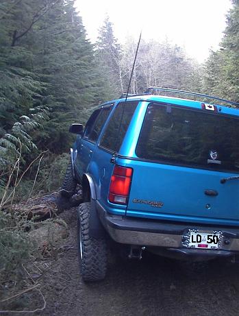

Okay, I got the Old man Emu springs on.
As I said, I ended up using poly bushing in the rearward side, and Stock ford bushings for the forward side. The forward bushing were ordered to fit a 96 Explorer.
I had to press them in myself, and I used a big vice and two big wrenches to assist. I wish I had a pic of that proccess, but I don`t.
The outside of the Ford bushings are not as wide as the inside is, near the metal sleeve, so I used the box end of one wrench that was big enough to push on the bushing without hitting the middle sleeved part. The other wrench`s box end was used to keep the other side of the sleeve from hitting the vice when it was pressed in.
The polys come in two pieces, and I used a mallet to bang them into place, and then used the mallet to bang the sleeves into the bushings.
Anyway, here`s some pics:
Gettin them on, no need to explain the process again ;)
Big difference over my modded up stock ones. They compress easier, but in a graduated way, which is part of the design if you look at them closely. They aren`t as stiff, and don`t snap back when you hit bumps at higher speeds, which keeps you from going sideways. I went for a little run today, and I am happy with them, although they were expensive!

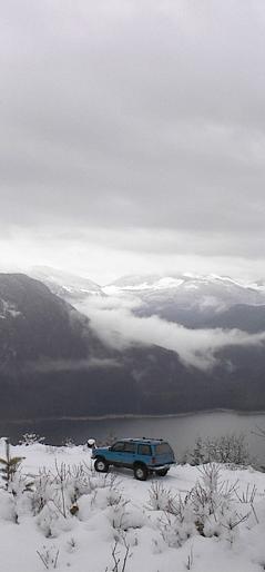

Jim,
That last pic is too awesome, must be nice to have such acool playground.
Originally posted by X-1
Jim,
Ah beautiful BC wouldn't live anywhere else.
Glad to see you got out today James, did you go alone? I'll go next time for sure.
carson
I can be at that playground in about 45 minutes! Half hour later I can get a pick like that :D

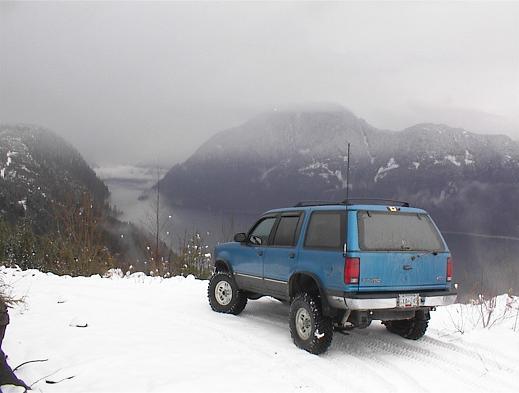

-Did go alone Carson,with the family. I actually fully explored that trail with the big ditch and the steep hill that I got up that time but didn`t check out. It actually has a great view of Stave from there and definitely will be less crowded. Here`s a pic from up there. Had virgin snow everywhere even to the main lookout!
