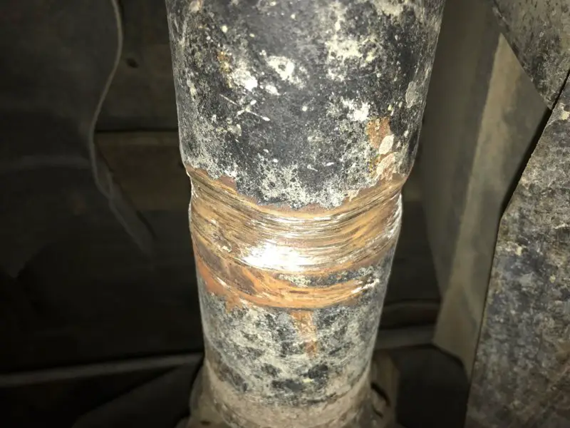

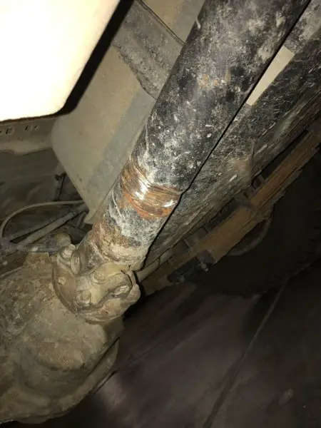

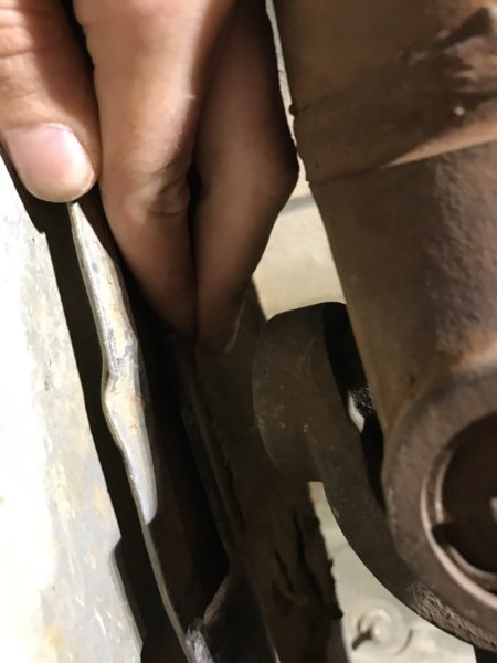

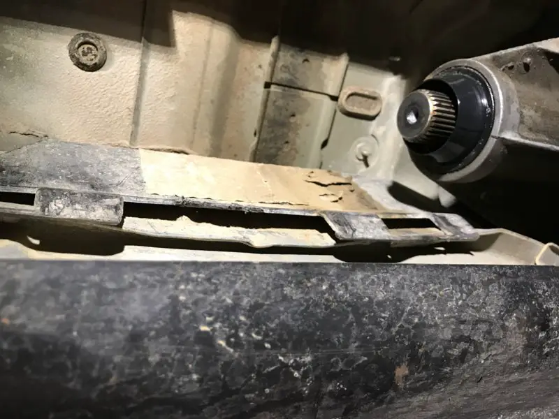

Just found this bit of damage last night. Can’t believe it held up like this while pulling another rig on the trail too, and then no vibrations on the 350 mile drive home.
That's impressive. When I ran the Rubicon, my rear drive shaft had a slight barber pole groove towards the axle side. Not nearly as deep as those.

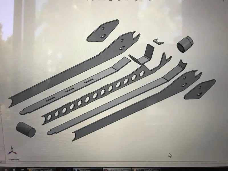

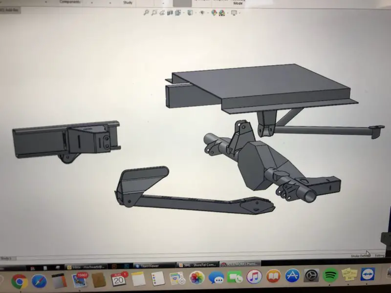

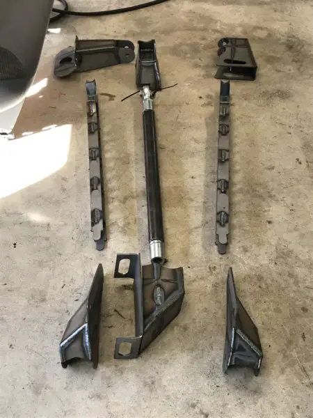

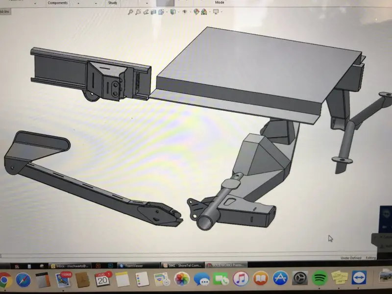

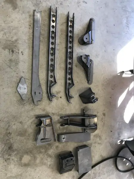

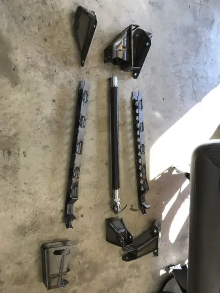

This is very premature, but I had been working on the 3-link design for a while and decided to take advantage of the 3 day Labor Day weekend and have everything cut out ahead of time so I could weld it all up. I spent a full day forming everything and tacking it all together, and 2 full days welding.
Also finally got a new driveshaft, but it has a larger yoke than my old one and would have hit the gas tank, so I took care of that issue.
Are reusing the front spring hanger for the link mount?
No, that would make the links only like 18" long haha. The brackets at the front of the trailing arms are the frame side mounts. Also I don't know why the pictures are in such a random order.
