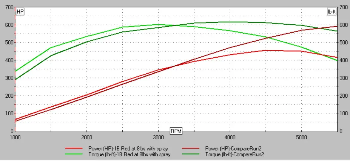

It is about as close to the blower intake as you can get without spraying directly in. If I am not happy with it there, it can be moved. I am sure some cooling will go to the elbow, I'll soon see if too much is lost there and if I want/need to move it based upon what I get when data logging IAT's.
I'll share results. I also heard you on duel staged nozzles, but I am going to start with a single number 6 injector. I think it will be enough at the 6-6.5lbs I will be running. It may be too much based on what I have read. They included a number 4 and 6, so I probably need the 5!
I read of an increase in boost with the denser air charge. I'll soon see if it produces a bit more boost. Did you see an increase?
