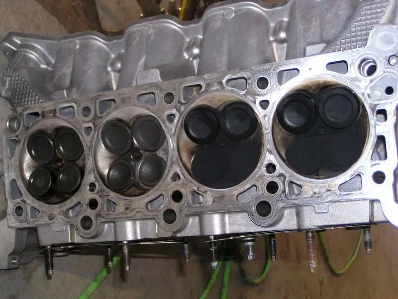

I find it kinda interesting that it looks like they all died in the same spot on the piston..
And per a discussion on the phone yesterday these are the two primary pistons that always take the beating when something like this happens.
Also, after doing so searching it is known that KB blowers, even as far back at the 1.7 have see higher than normal IAT temps, so if there is a problem as noted by another fellow technician, that if the blower has an issue then the temps will be even higher than that, and will saturate the intercooler, causing higher IAT's and the distinct, high probability, of detonation and engine failure due to this.
