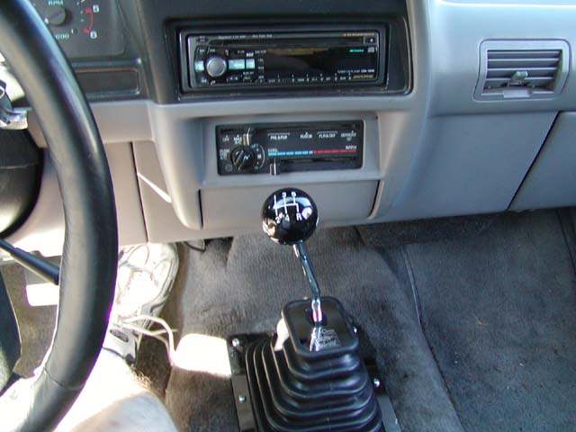

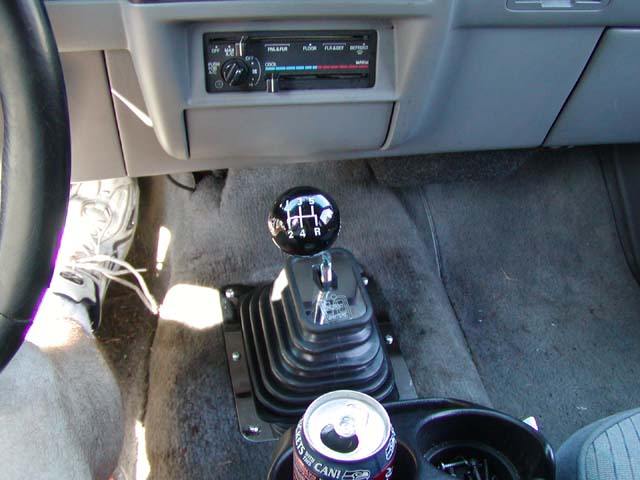

Well I got my Short Throw Shifter today. I don't have any befores, but it was like any of the 5spd shifters out there (just prolly ALOT sloppier). Here's some after pics tho. Part# 391 5020 from Hurst. I ordered mine from Summit for $199. I am happy simply because I can use my cup holders again for 32 oz cups LOL.
Side shot:
And first Gear:
And Second:

As for not working with offroaders, I dont understand that either. Yes, it would be AWESOME for street, but should/does function fine offroad. I had two reasons for installing it:
1) My stock shifter was so worn out, the slop was getting to me. Why pay for a stock shifter, when I can simply upgrade. Its now a defined shift pattern again.
2) Yes I can use large cups in my cup holders now! By far the main reason I went for the short throw. My son & I spend ALOT of time in the X and almost always have something "CRUSHED" in the cup holders. It got old.
All the short throw shifter did was shorten the throw. My shift pattern is now maybe 2 inches between gears. I can't see how this will negatively affect it offroad. It is shorter from front to back and side to side, so I don't see how a manual transfer case would be affected either.
I DID NOT install it for speed shifting, I realize that it does not make any sense in a 4x4 :rolleyes: Nor would my truck even pretend to be fast with 33's and 3.73 LMAO.
I like it, thats all that matters ;)

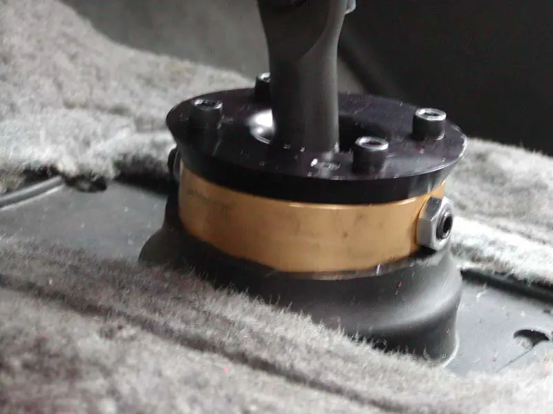

As for the body lift/shift extension, here's 2 pics without the boot.
The black boot you see is the stock inner boot that used to cover the shifter pivot point.
thanx for the pix but that doesnt do me any good. i need to see under that flat rubbert "inner" boot, i mean like see the top of the tranny.
Under the inner boot is the same as factory. The section you see, bolt directly to the top of the tranny the same was as the factory shift. Just uses longer bolts.
