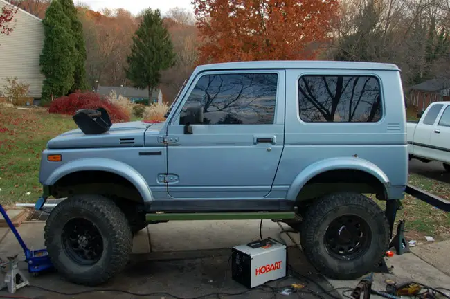

Well this rig isnt going to be pushed as hard as my Explorer -- so it probably wont get too much dent/scratches. But even if it does get beaten up, thats what sheet metal and the Hobart is for :D
but they look so much better beaten up :D
31's -- ride height.

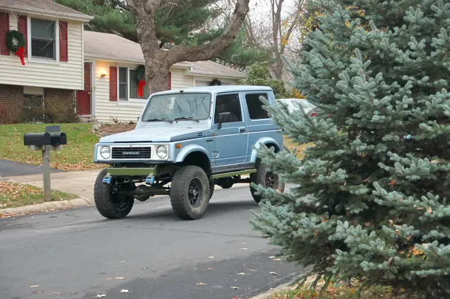

Got it up to third gear today, felt good but didnt have any shocks so any bumps on the road was a little iffy
In front of a Burb:
Interior needs a bit more TLC but the tank is finalized. We also sliced up the old hitch that used to be on my Explorer and adapted it to the Samurai.
This is the "ladder" thingy that supports the gas tank / fuel cell from underneath. A temporary pipe is at the end of the muffler just to get the exhaust away from the open floor -- but it will get a bent pipe and will exist on the rear-left corner.
For now the vehicle is back in its storage spot. My brother is going back to San Diego tomorrow morning so next time it'll move is around Christmas. But other than the small things Ive mentioned, we only have a both bumpers, a tire carrier, shocks, something to cover the rear, and thats probably it -- then its off to the West coast! :D
