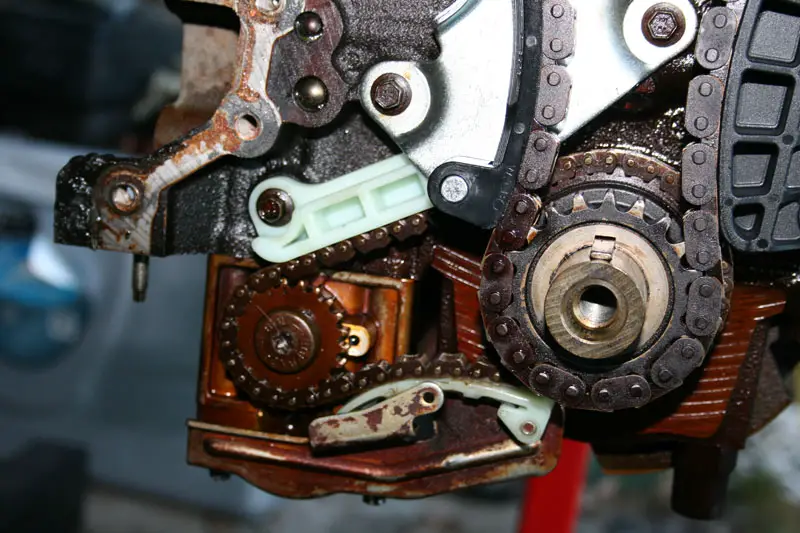

The cold start rattle may be more due to a lack of oil than cold. My cold start rattle was due to a broken rear guide assembly. Even aften replacing all of the failed camshaft timing components the engine still rattled at cold start for a second or two. I eliminated all cold start rattle by installing a pre-oiler. The only way to know with certainty the source of your problem is to visually inspect.
