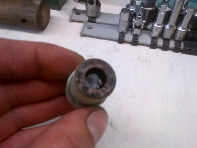

I wish I knew exactly what the issue was, but the TB and PCV were filthy, and found a small tear in one of the old plug wires. I am not sure how dirty PCV valves should get, but I am thinking this one was stock as it read motocraft on it....
I highly suggest anyone doing manifold gaskets to change your PCV while your at it as its easily accessible then, along with the thermostat. I read about people having problems with the "T" connection on the PCV, but since I had the whole thing with hoses out of the truck it was easier I guess and the new PCV easily slid right into the "T" connection. I forgot how much fun plugs were in these but with the passenger tire and splash guard off it wasnt to bad I guess.
