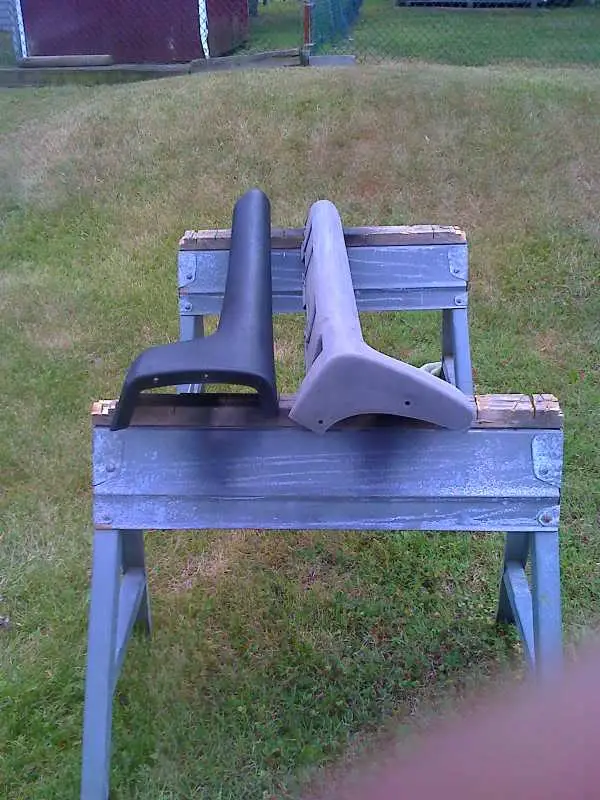

Yes you can paint it. This is my wifes truck. I smoothed all the texture sealed and painted it with Dupont paint. Factory yellow with some pearl in it.

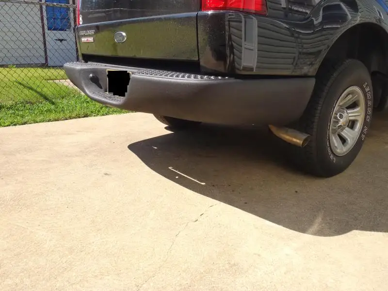

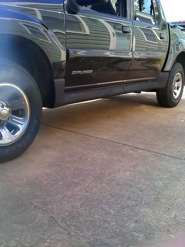

In the process of painting mine. Did the side trim so far. Finishing the front and rear bumpers this weekend. Here some pics
I'll post up finished pics of the front and rear bumpers on monday or so.
Maybe it's just the light but they look like they're not evenly coated, kind of splotchy looking if you know what I mean.
The sun was on the passenger side but the paint has a rough texture to it as well.

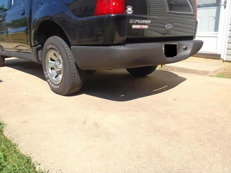

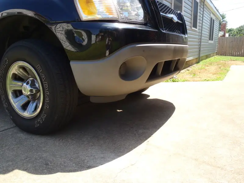

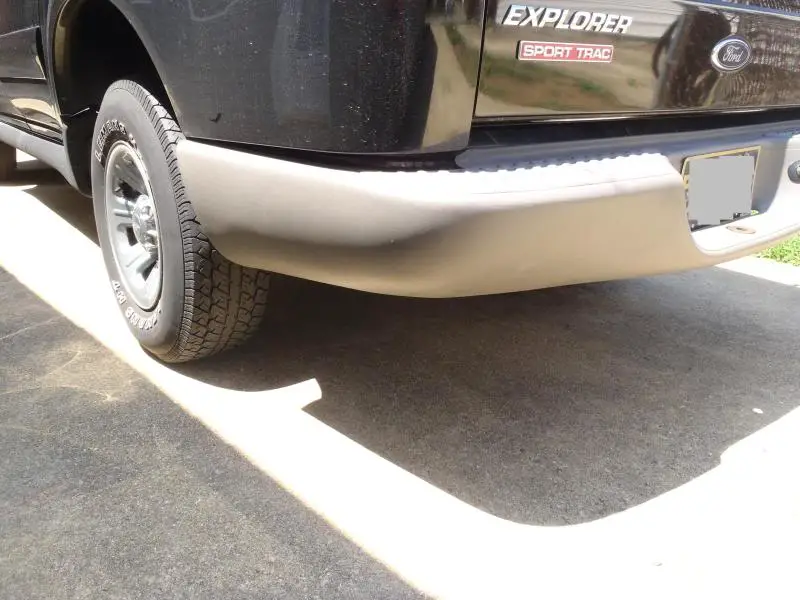

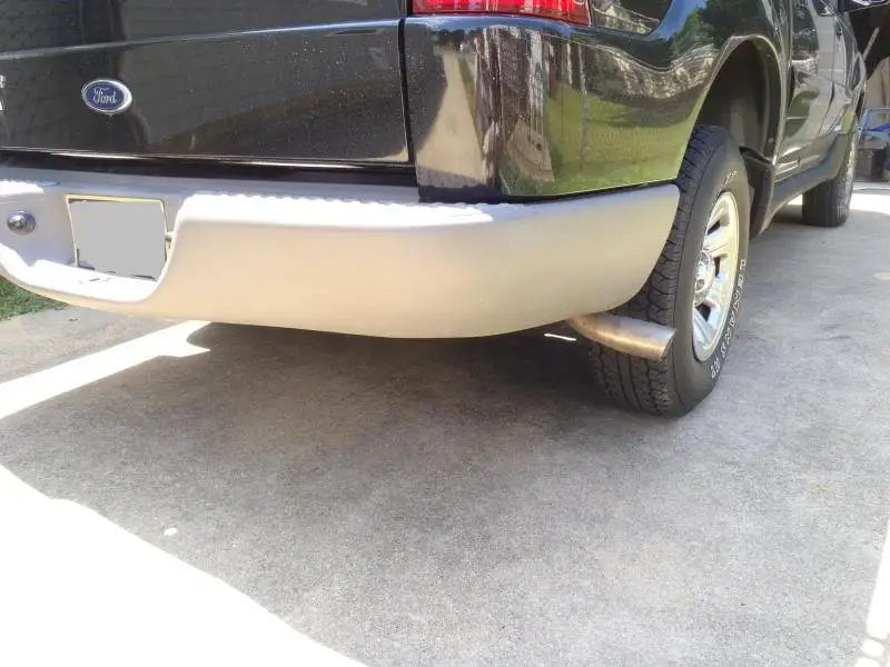

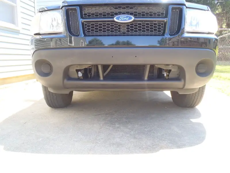

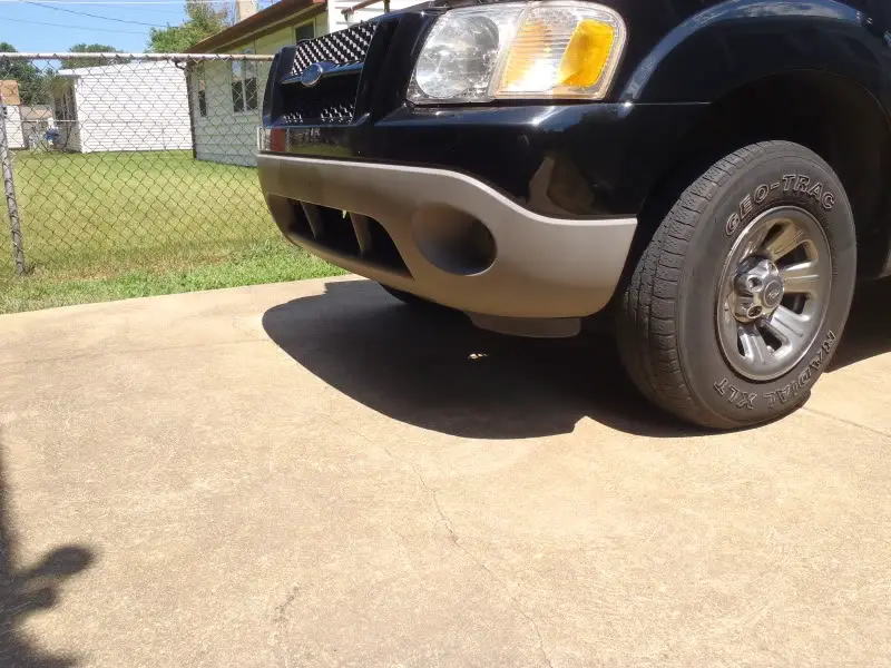

Heres the befores and afters of the front and rear bumpers
Looks good man.
