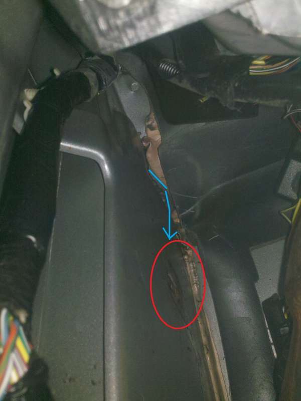

I seem to have purchased a very odd Sport Trac... Opened my driver door after two days of rain and had a river run out from my door sill :fire: Traced the leak origin to someplace under the dash (roughly straight back from the top of the dash fuse box to give you an idea of location). It's been coming down behind the kick panel for at least 4+ years, running along the parking brake bracket to the floor, where it promptly soaks everything all the way to the rear seat on the driverside (do you have any idea how hard it is not to punch the previous owner in the face for this every time he comes in for service on his new truck?!?!). The body harness was completely submerged Removed the cowl, wiper mount/wiper transmission arm, left front fender and parking brake assembly, used 3m urethane windo-weld and seam sealer spray everywhere I could reach...... and water still pours in. I tried smoking the interior with our Halloween fog maker (that was a disaster. Warn your fire dept before attempting this at home, kiddies). Although the smoke crept out, I can't determine its origin because of the way it snakes around the wiper trans tunnel and door jamb. No, I don't have a sunroof and no my rear window/ 3rd brake light don't leak.
Anyone have any ideas??
