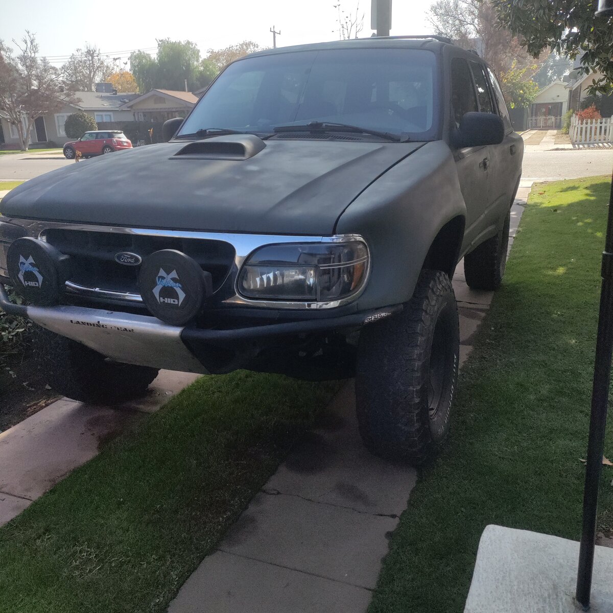

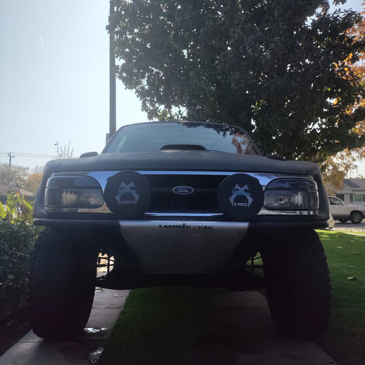

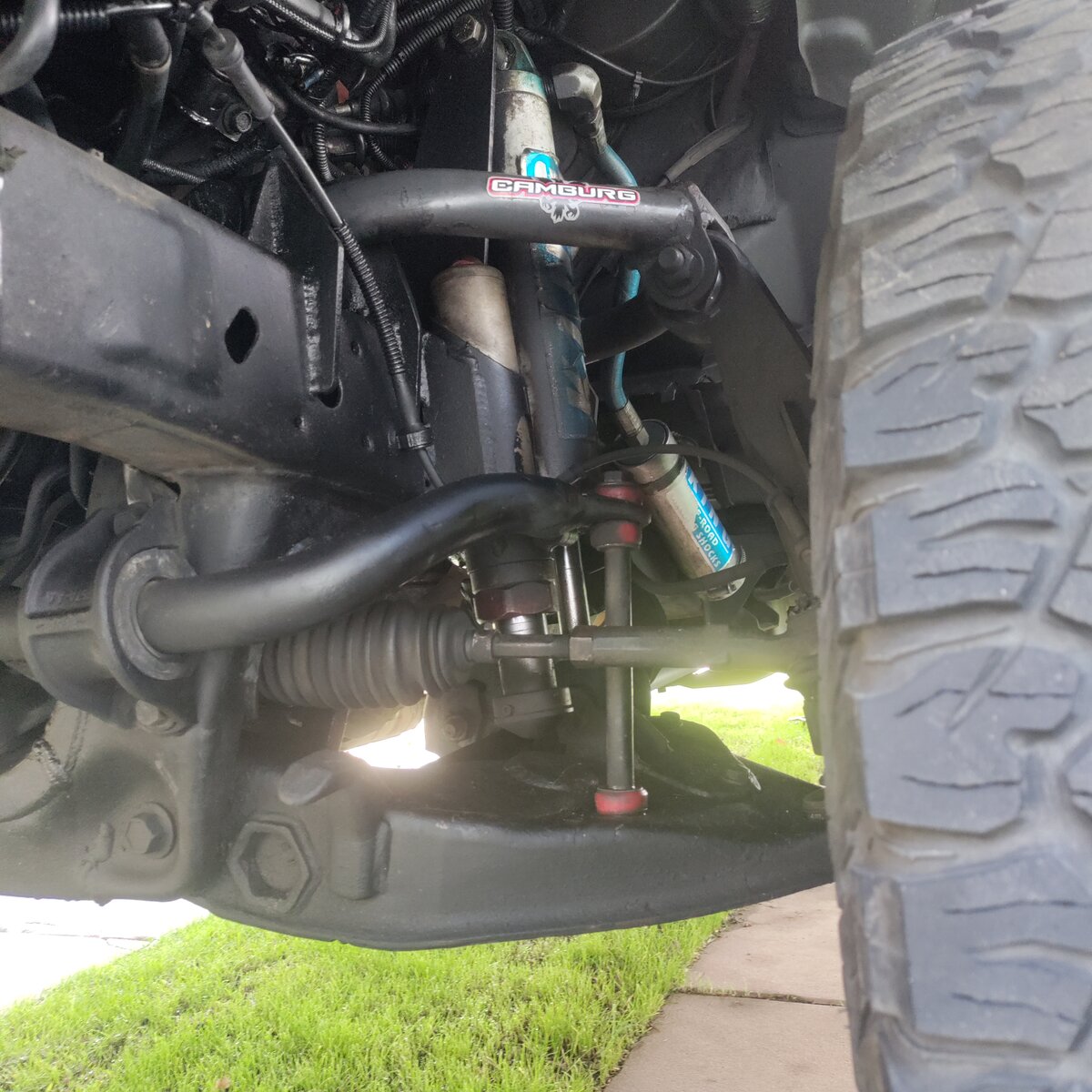

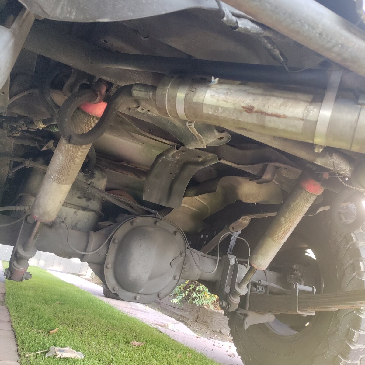

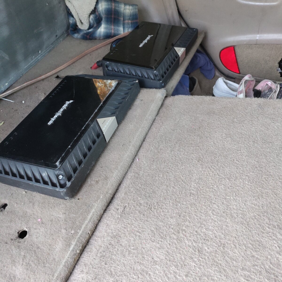

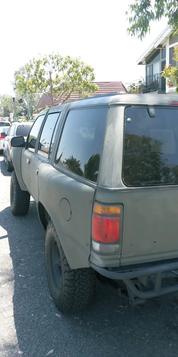

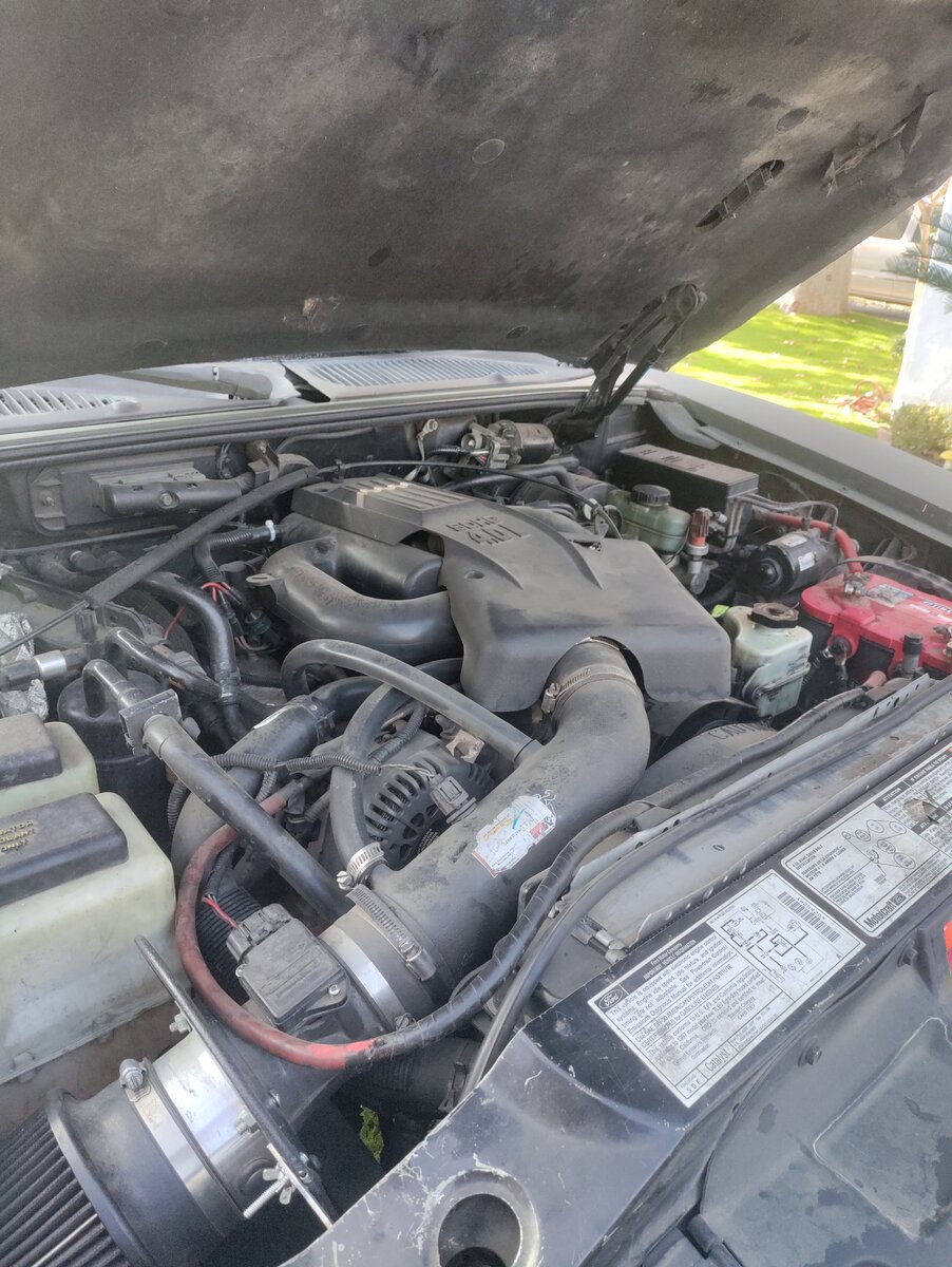

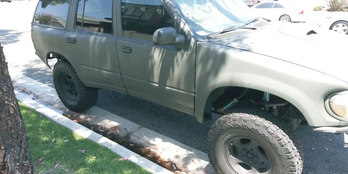

I'm new to this forum. I'm from so cal and have a 97 expo with a ton of work, mods. Hrs, love etc. Into it. Started with camburg edge a arms and spindles. King 3.0 remote reservoir, sway away bump stops, limiting straps up front. On the Rear I swapped to 410 hearing for 33s. Deavers leafs and sway away 3.o remote reservoirs, new shackles. The body has fiberglass front end and rear bedsides as well. Custom bumpers front and rear with hid lighting. 4.0 motor with built automatic trans. Flowmaster Exhaust with turn downs. K&N intake, bamachips tuner, upgraded alternator and red top battery to support fosgate power 13 inch 4,ooo watt Max/2,000 rms sub, 2 fosgate amps, o Guage big 3 upgrade, 6volt pioneer deck, focal components front and rear doors, fully dyna matted interior. I Love my rig

How has the sohc engine treated you? Is that still a 97 engine?
What steps have you taken to keep the trans cool?I was surprised to see a front sway bar!!

Funny you mentioned the sway bar, because I noticed it too and had no idea until now that the early 2nd gens had the sway bar mounted to the front of the crossmember vs. the bottom of the frame rails forward of the crossmember. When I had A-arms still I got rid of the sway bar and loved how that improved the ride quality.
It definitely improves ride quality and definitely travel off-road but on road I feel the truck leaning hard into any turn on road at any speed. So I keep it on riding on the highway. It's 4 bolts easily removed and the two links no big deal before I hit the dirt. The back sway bar is gone you probably noticed. That one is gone gone.

Bamachips tune eh? Iv heard of a couple people that used to tune these sohc back in the day to increase the redline and tune in some more power. Welcome
