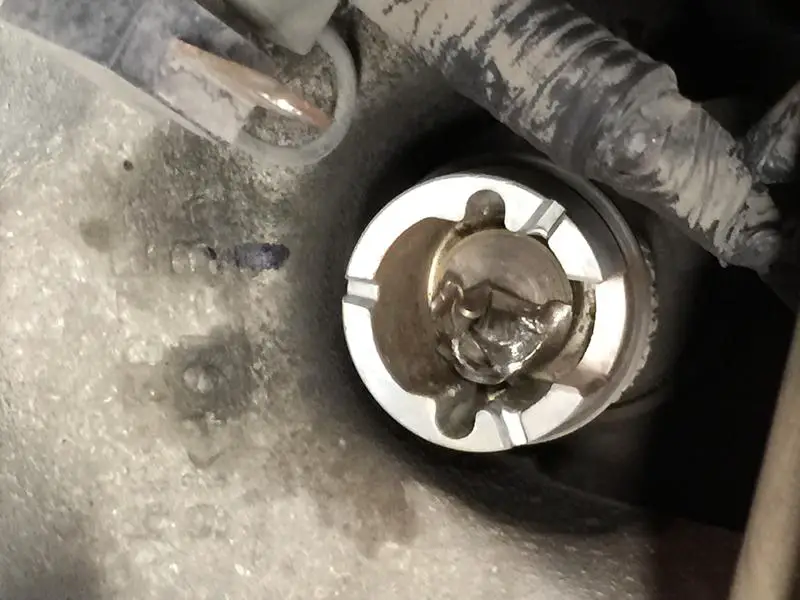

So glad I FINALLY got this done and yes the sensor was mangled. A friend from work who used to work at a Ford dealership helped me do it and he did it in no time like it was nothing. But no more chirping and I feel better knowing the synchro drive has been replaced with a new sensor too.

My phone won't let me upload them all together so I gotta make a separate post for each pic

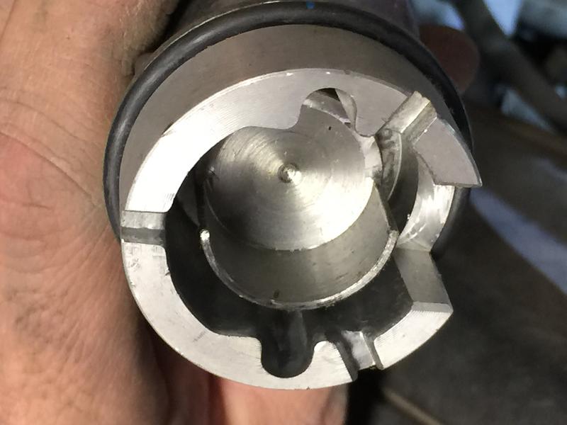

The new motorcraft synchro drive
