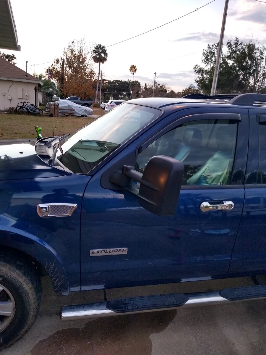

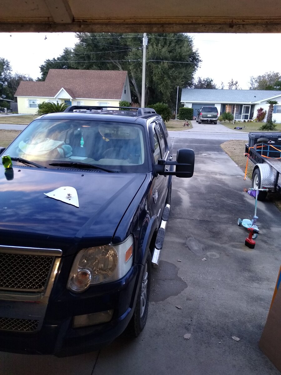

I know every explorer/ sport Trac owner is sick and tired of our tiny mirrors or wobbly aftermarket strap ons. Look no further, I found a combo that works and to toot my own horn it's brilliant.

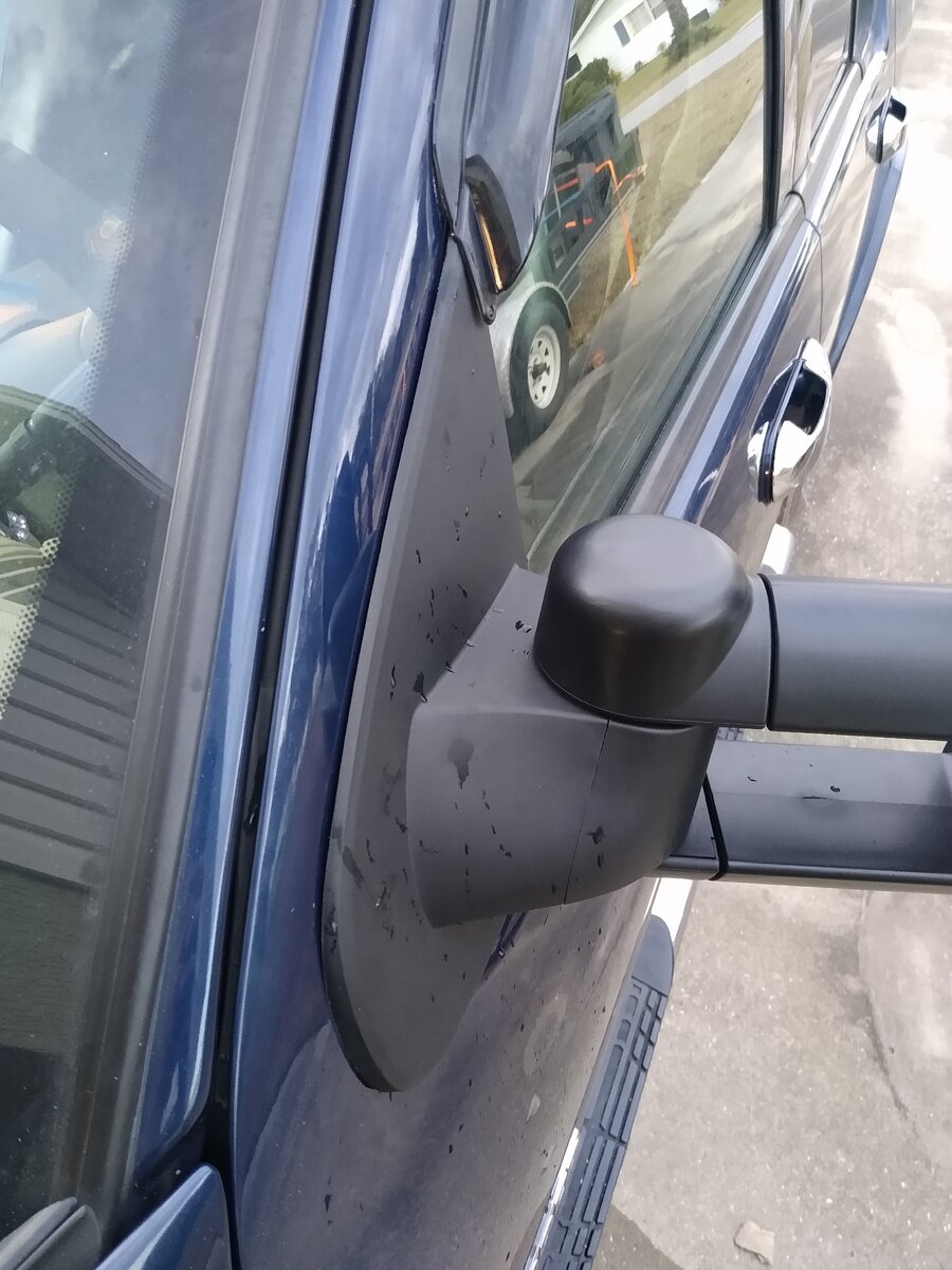

I ordered 2015 GMC 2500 tow mirrors off Amazon for about $80.. I had to cut the front bolt off of them, trim down some of the having on the back, drill two new holes in the door, and add a few washers.
Definitely wasn't rocket science. Just took my time and trimmed a little at a time.l was even able to wire to factory adjustment switch and defrost
