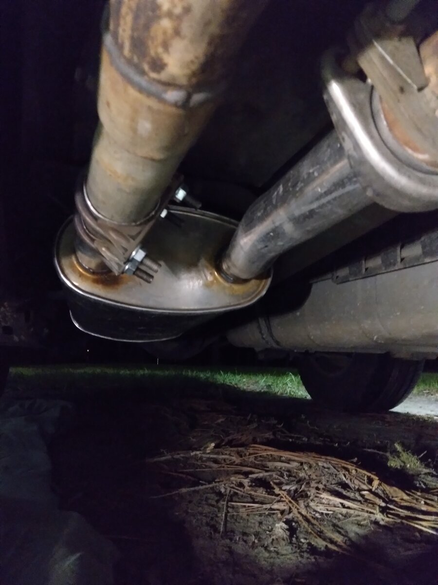

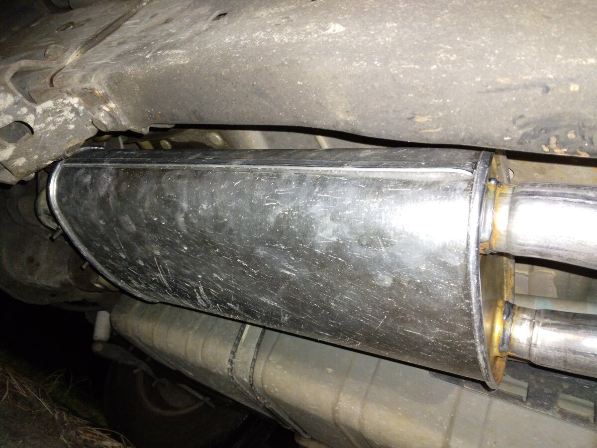

Just another job done today that again improves the '97. I have been listening to the cheap muffler slowly get worse since I got the truck in Feb. So I ordered a Walker sound fx muffler (18564), as I wasn't going all in on a performance exhaust, yet. With a handful of couplers and clamps I was able to eventually get the muffler installed. Although I had some issues: twin inlets didn't match factory side, had to pull them apart about 3/4 inch; it wanted to sit low at first due to the angle of the coupler on the non flange side which I used a bottle jack to ease it up into place; and of course at first start it leaked like my wallet buying parts for this Explorer, but a few more cranks on the clamps cured that minor issue. Truck is super quite and seems slightly more powerful, slightly. First attempt at exhaust work myself and am very satisfied with the end result. After, pics coming tomorrow. Thanks for not falling asleep reading this.

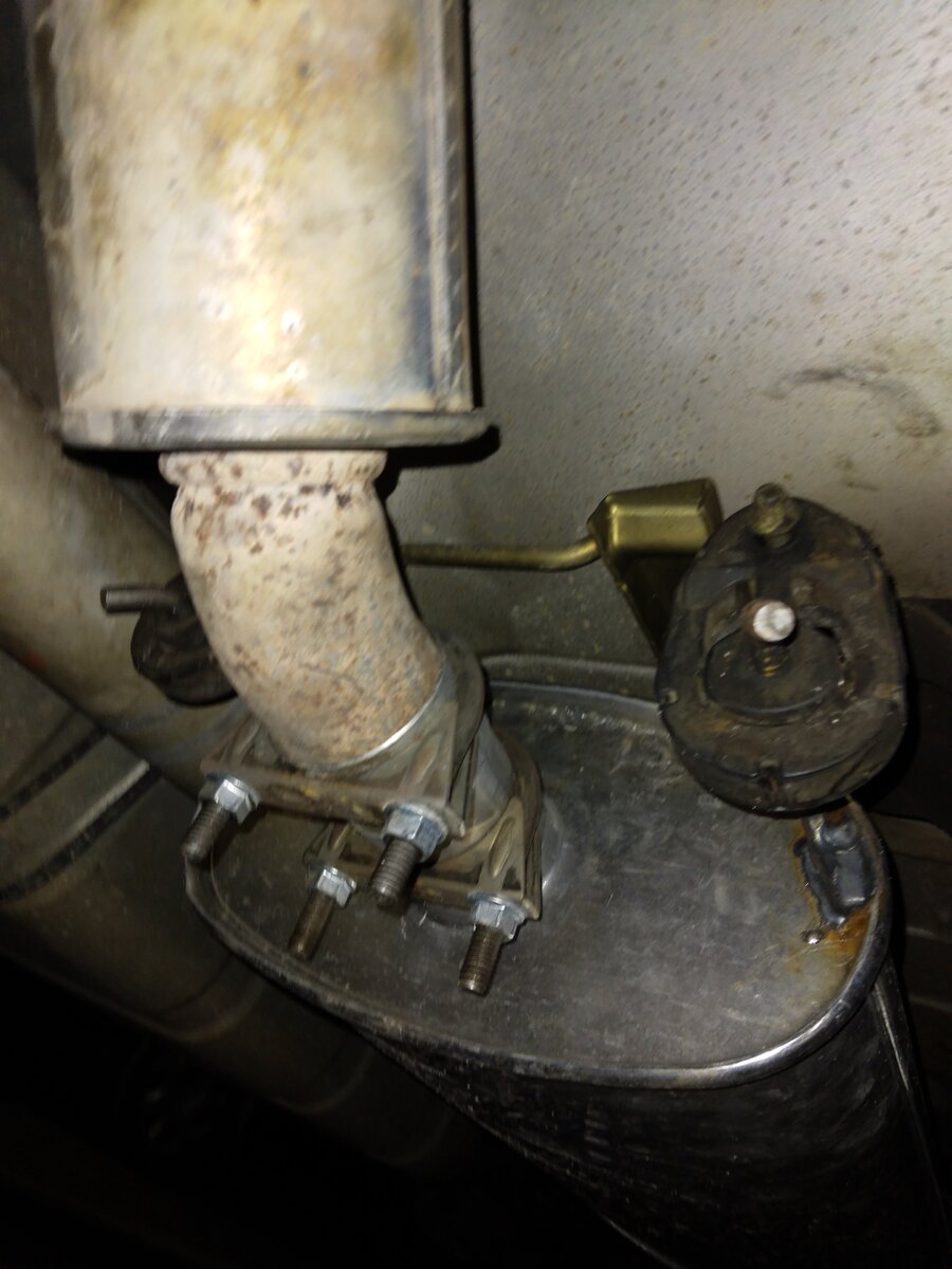

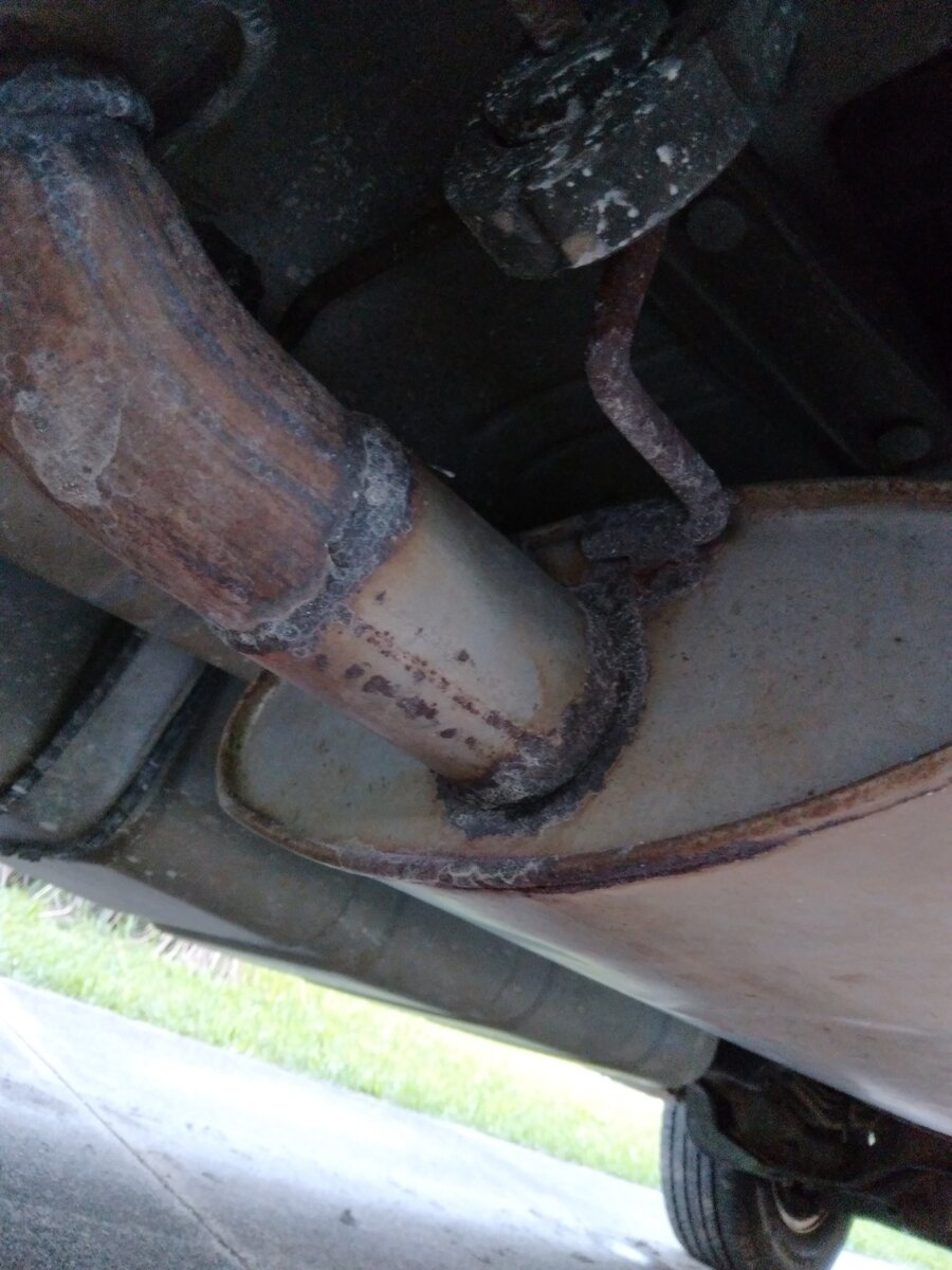

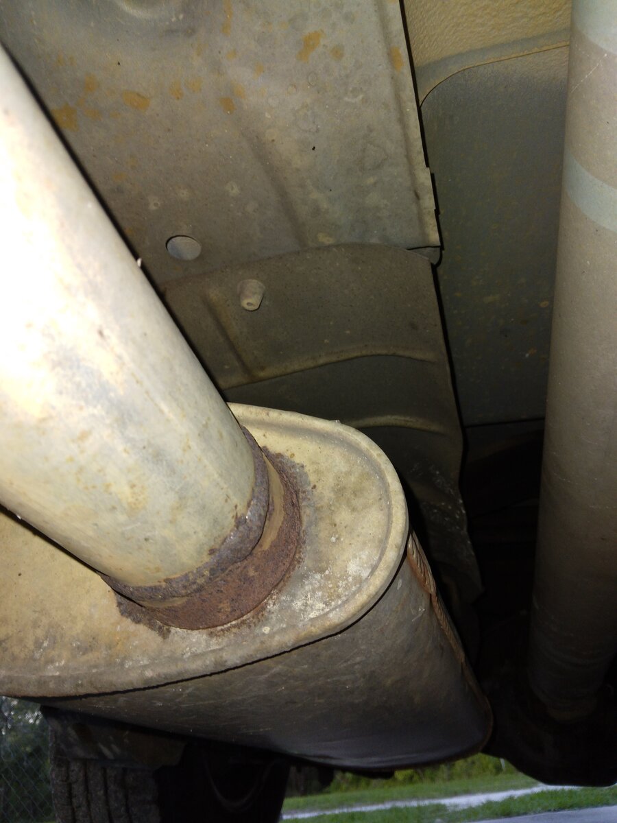

More pics, no sound yet. The old muffler was welded in...
20220726_212613.jpg 20220726_212252.jpg 20220726_212310.jpg 20220726_212340.jpg 20220726_212321.jpg 20220726_212015.jpg
