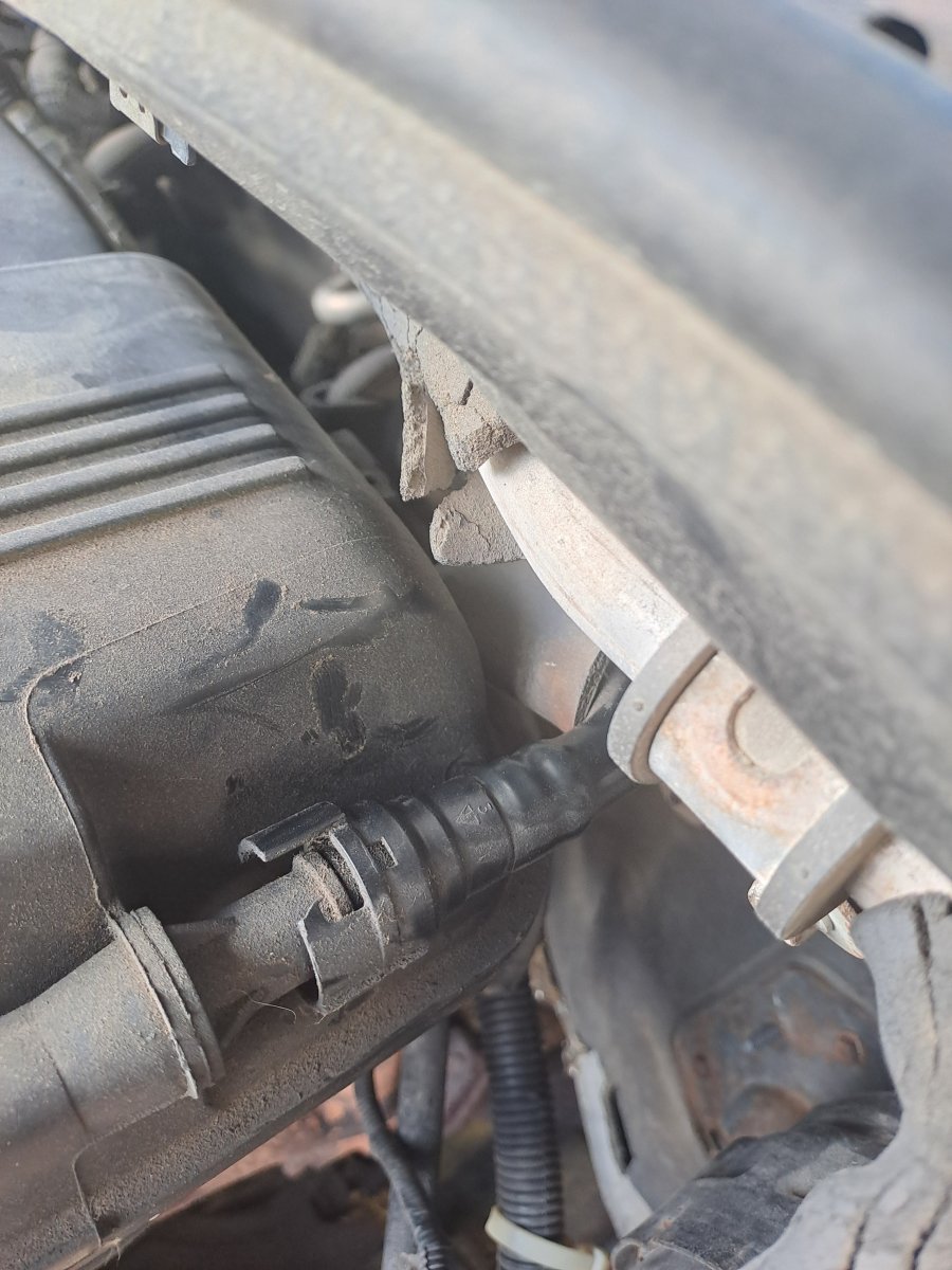

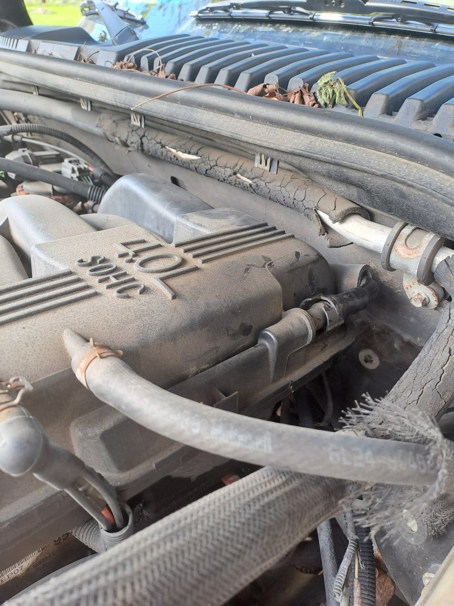

I am trying to identify the hose that is missing the clip, keeps popping off causing stalls. 06 XLT 6cyl
The one in pic 2, it's supposed to have a plastic clip/ring to keep it in place and that is gone and it keeps slipping off causing a vacuum leak and then it stallsIf you mean the hose coming off the corner of the intake, that connects to the PCV valve that is in the back side of the valve cover.
While I don't, if you have a decent Ford parts counter guy, show him your photo and he should be able to get it if they still make it.Anyone know the OEM part # at all? Trying to pin one down is proving difficult without knowing what exact part I'm looking for?
I couldn't find the full part number, but a partial one on the ford parts website. It's item # 6A664 in the engine schematic diagram at the below link for the PCV valve.
