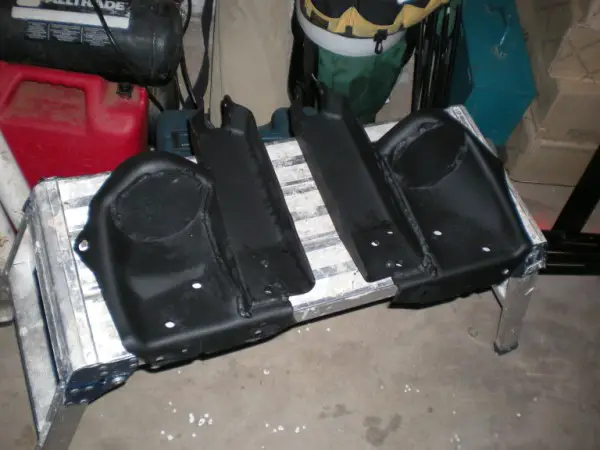

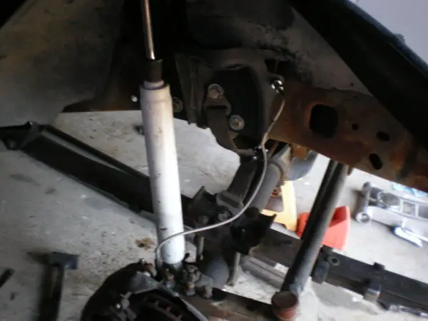

Yes it looks like I may get some shocks on this thing. I cut the stock shock mount off the coil bucket and welded a F250 shock mount in its place. I also cut the fingers off and put a 3/16" plat in the coil bucket. This is for when I do a coil front suspension in the future. It will be similar to a Tj setup with a pipe down the middle and a bump stop on the bottom.

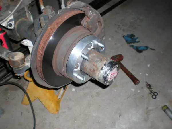

After that I added some 1.25" wheel spacers to the front. This is to keep the tires off the springs and shocks. Also will make for more clearance when I go to bigger tires. I went with spacers instead of new rims because I didn't want the rear any wider.

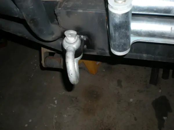

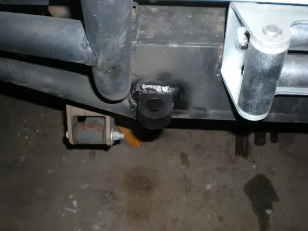

Then I decided to add some tow points to the front of the truck. These are 4" long I have them welded along the front enges then a few inches of weld along the back behind the bumper. When I pull the bumper next time I will run a few more beads on them.

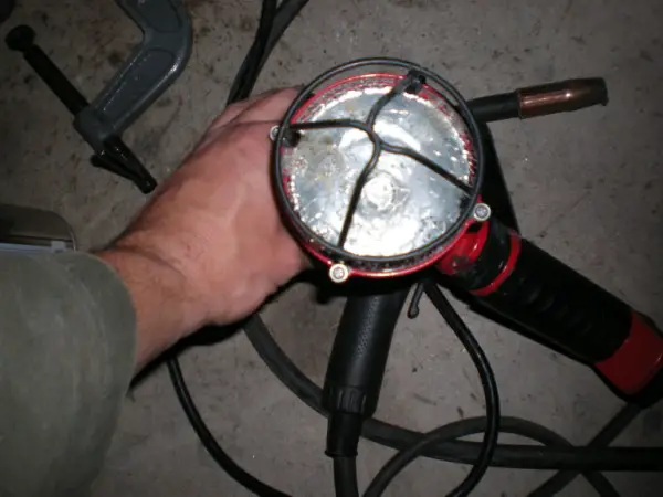

Also keep your work light away from weld splatter or the lense will crack.

I like that setup with the coils. Where did you get the shock mounts? Would that coil mount setup work with wristed early Bronco radius arms?
Looks to be the famous F-250 shock tower mounts, Ford part E5TZ 18183A -- usually around ~$20 each at the dealer.
You can get the shock mounts almost anywhere, BCbroncos, bronco graveyard, wild horses, etc... Yes, that coil set up will work with the wristed arm. Mine is almost identicle, except I am using Bronco coil buckets instead of the Ex ones. I bolted my shock towers in and then later welded them to the coil bucket.

I have the same tow hooks Matt:thumbsup: I just need to get the rear ones in before the next trip:rolleyes:

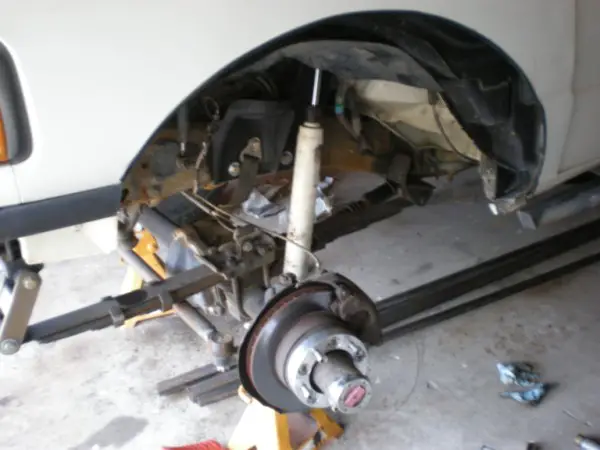

For all the haters that thought I would never have shocks for the next trip her you go. :p:

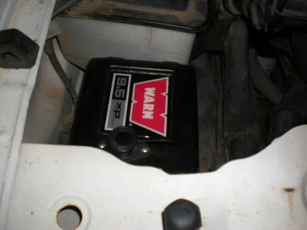

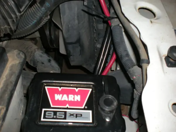

I also extended the cables on the winch solinoid pack. The winch has been on the truck at least a year but I had not wired it. I just have one more small ground wire to extend and then I can put the cable on it and use it. I also need to get a dash mounted control unit as I will have to open the hood as it is now each time to plug in the controller.

Wow Matt, it's almost scary how much work you've got done on the truck...you just might make it up CJ hill now with all these mods:p:
huh.... Shocks must be Photoshopped in:rolleyes: I did't know you were so skilled Matt:p:
