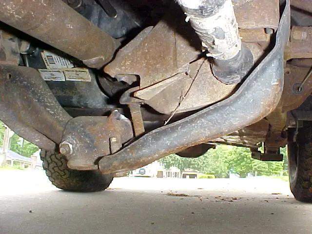

I broke my lefthand frame at the rear torsion bar holder bracket where the tranny crossmember bolts to the frame:
You can see the break just to the left of the torsion adjuster bolt and the resulting tranny crossmember drop of about 3". My plan to take care of this is to buy a Superlift; by using the Superlift drop brackets to hold the torsion adjuster, hopefully I won't need to worry about refabbing the break. However, I don't know if the Superlift drop brackets bolt onto the section that broke off, or just bolts onto the outside part and bypasses the break. If the Superlift bolts onto the part that broke off, my plan obviously won't work. I need a clear photo showing the Superlift drop bracket install; or positive, knowledgeable confirmation that this will work before I spend the $$$$ ordering the lift kit.
I will still have to fix the break so that I have a tranny crossmember support but that will not require near the strength of handling the torsion pressure, so I'm comfortable with that. I am NOT comfortable with merely having the break re-welded, using it again to hold the torsion stress, and then waiting for the weld to fail again while out on the trail in BFE several states away from home.
