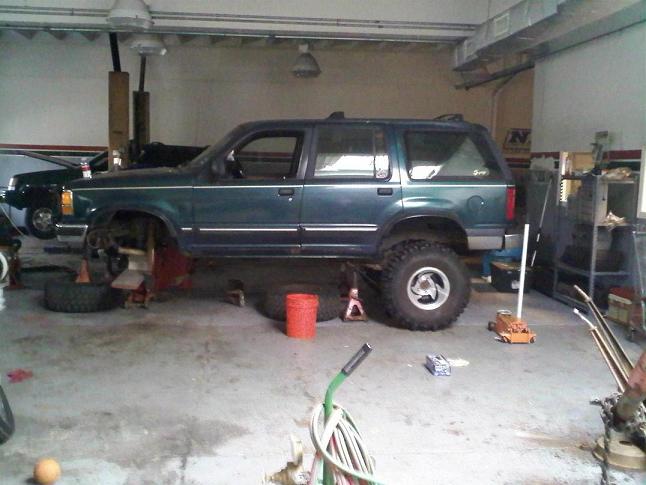

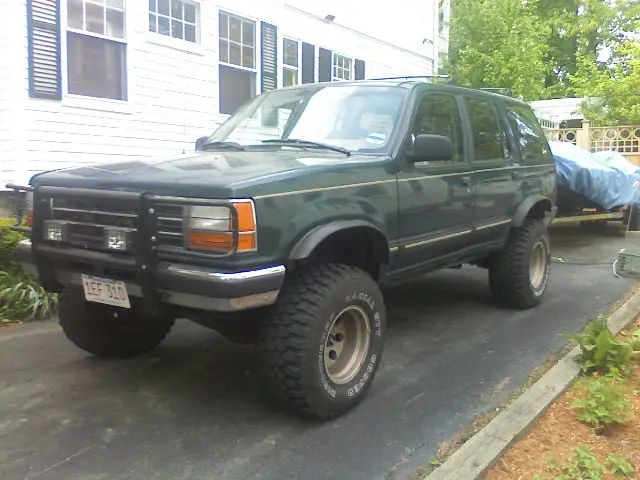

What's up everyone? I got the itch for more lift about a month and a half ago so I started looking into cheap options to add another couple of inches to Bill Bob's ride height-at least enough to clear 35s. Unfortunately, while checking out the methods the previous owner had used to acheive the current lift, I realized I had already been running a fairly cheap lift setup in the first place which consisted of bigger springs/spacers in the front and SOA+AAL in the rear. As you can see from the before pic, this setup allowed clearance for the 33x12.5" tires that had come with the truck. I had a friend (who is ASE certified) check the truck out so we could formulate a plan of attack. The factory D35 was in pretty bad shape anyway with tons of rot :eek: When that new information came to my attention, it was pretty clear that I was going to have to go with a D44/9 inch swap to get the results I was after. The 9 inch rear is from a 78 Bronco I pulled out of the woods near a guy's house in New Hampshire and the front is a D44 out of a 78 F150 from the boneyard. There wasn't much of the donor F150 left at the yard, except a set of fairly beefy aftermarket springs and buckets that we paid $20 for. I got a great deal on a set of 35x14.5" boggers with 95% tread left on 15x10s 5.5 inch pattern. Netted out at $400 for the set including the rims :thumbsup: It's still very much a work in progress, but it has come along enough to where I thought I could start the thread. I'll post more pics as the project moves along. Enjoy!

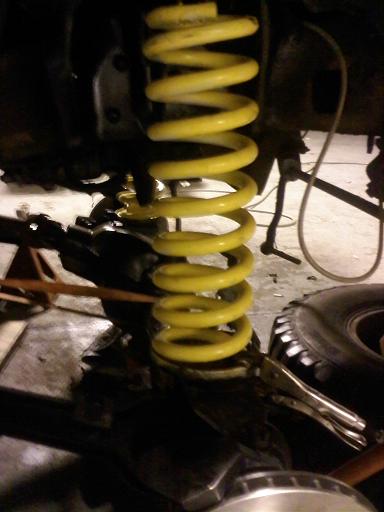

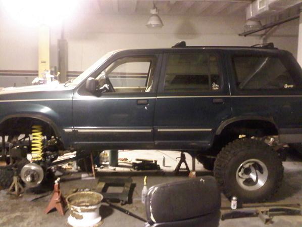

Billy Bob is slowly coming together. Got the front tires on last night after we finished the custom spring perches. There's a picture of the radius arm brackets, moved back about a foot, give or take. Still on the to do list is to finish the steering, scavenged out of a different late 70s F150. Also the brakes need to be finished up, and we will be fabbing up some custom shackles in the rear. I'll get a couple of pics of the ole stockers. They are litterally rotted through the center :D. I'd love some feedback/suggestions if anyone has any. Oh and excuse the sh*tty cellphone pics. I'll do a full set when she's all buttoned up

nice progress it looks real sweet with the bogger's.If you end up needing new replacment radius arm mount's( since it looks like there welded to the frame), I believe uhaul sells them for 20 a pair.Iy looks like it sit's about even, maybe a little but of a sag in the rear.You do know once you go solid it manditory that you paint your X a new color...j//p

fischerry- I wasn't sure what to do with the radius arm mounts. I figured I'd run them as is until I break something. It definatly sags a bit in the rear, not much, but enough that I'll need to level it off somehow. We even had to cut some coils on those F150 springs and it still sits a little high in the front.
That brings up a question I was hoping you all could help me with. What makes the most sense to level off the rear, another AAL (I already have one in there now), shackles (the factory ones are rotted, so I'll be replacing them anyway) or blocks? I can't decide.
