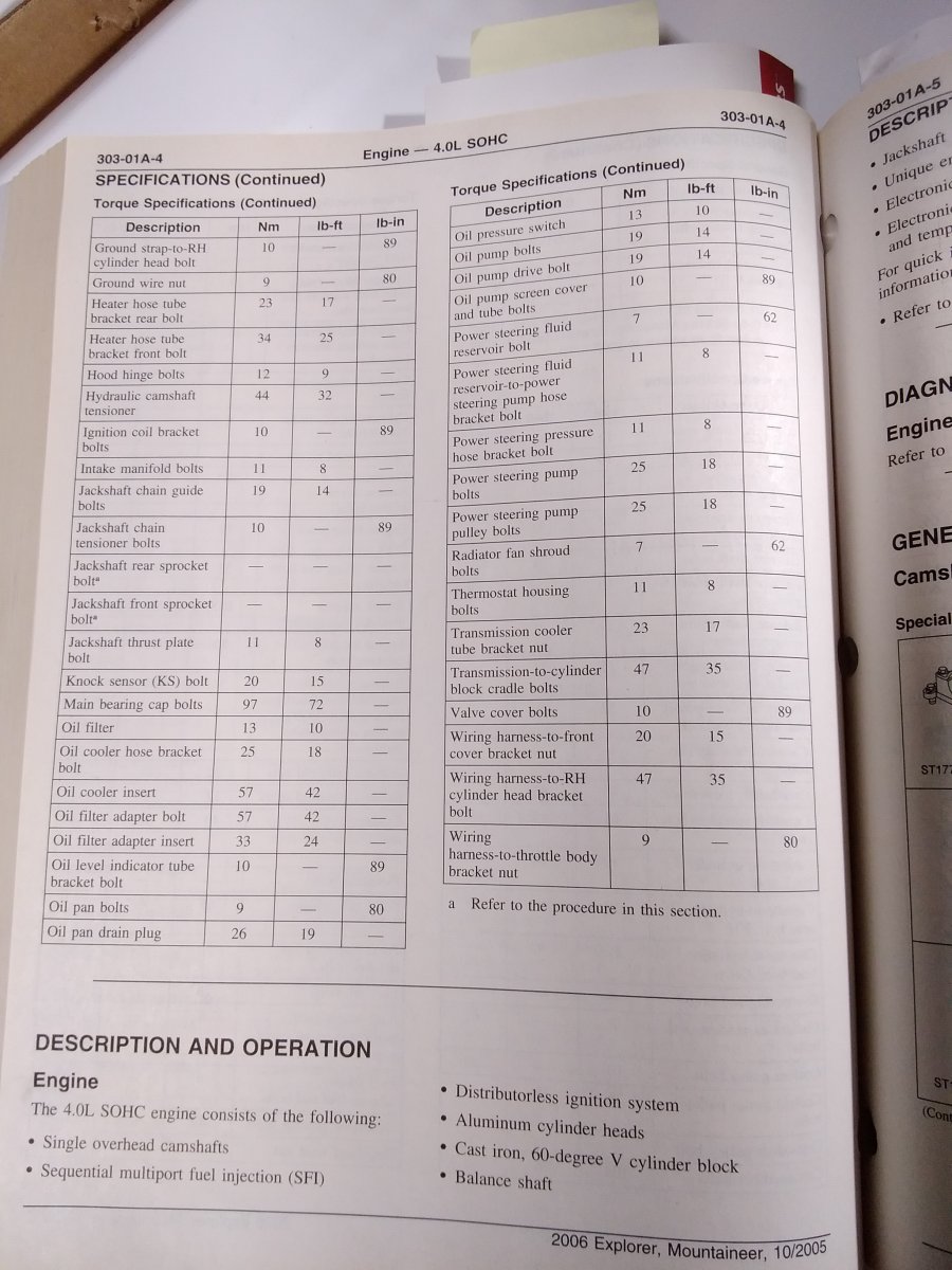

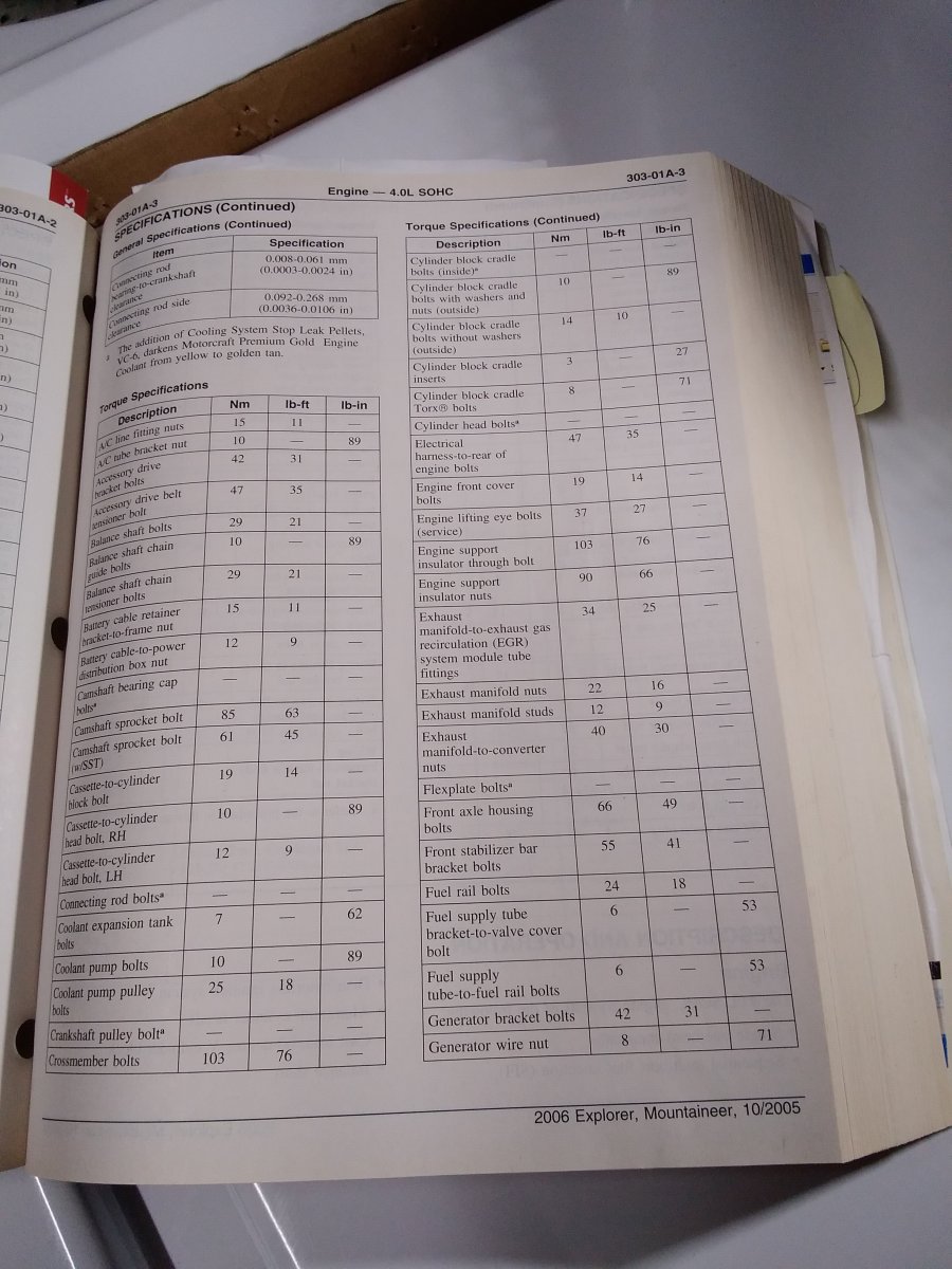

Just in case you didn't know, you can convert foot pounds into inch pounds by multiplying by 12. In other words 8 foot lbs = 96 inch lbs.Yes, very helpful. I can see I need 89 lb-in for Valve Cover bolts. And I need 8 lb-ft for the intake manifold bolts.

Edit. The slight amount of torque needed does make for a weaker click feel. Go very slow. If it feels too tight it probably is

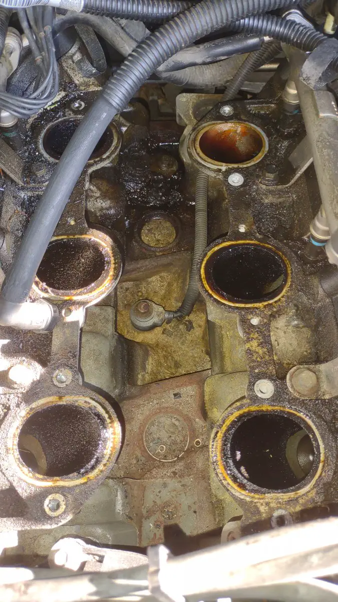

I finally got the intake manifold off of the engine. What a nightmare. And now the fun part begins. Getting the valve covers off. Do I need to clean the 6 holes on the engine in the screenshot, what are those holes called? Do I just wipe them down with paper towels or just let it be and have the engine oil clean it out when it's back together?
View attachment 452104View attachment 452105
